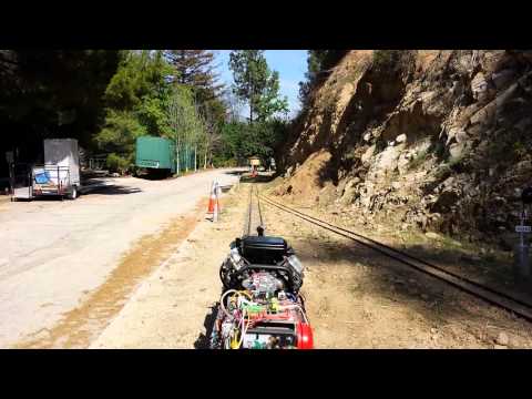

I have a motor control project that has been Basic Stamp for a long time. I keep upgrading the type of STAMP I use for more speed, etc. I can use SX or anything version I need.
What I need to do here is use a command speed (0 to 255) and use it to control a motor that drives my project. In this case it is a Train.
I get feedback that is MPH (again in the form of 0 - 255).
I am looking for way to compare the command speed ("peddle" 0-255), look at the actual speed ("mph" 0-255)
and generate a new speed command (throttle - 0-255).
I will need a couple of variables I can adjust to close the loop but this is a routine I am unfamiliar with.
I would appreciate any help I can get. I would like to use my normal speed control to get myself to a particular speed then turn on the sub-routine so that the STAMP program will then hold the speed.

    That aside, how are you presently sending the throttle value and getting the actual speed back?
  • It is sort of a model train...
    Its 1/8th scale.
    I have a Dial on a Pot that I read with an A to D Converter. I generate a throttle number (0-255) and send it to a Hobby Servo that operates throttle on a carburetor.
    I am using a gear tooth sensor on a wheel and COUNT to get my actual speed.
    What I have now works well -- This is a rideable train.
    When I go up small inclines I need to give the throttle a boost to keep up my speed. When I go down, I need to let up a little. Basic cruise control.
    I just don't have a clue how to do such interactive programming.

  • If you go about 1:30 in on the Youtube video, you can see my display panel that shows me going about 4.5 mph. (upper left hand display)
    4.5 mph is represented as 045 out of 255. Max speed is about 10 mph
    On flat level ground with a small load, my throttle command of about the same number will give me the same speed.

    Basically what you need to do is use the difference between the speed the dial pot is set to and the actual speed you are measuring to adjust the throttle position. The difference between the set speed and the actual speed is the error, which would be used to determine how far and in what direction the throttle needs to move.
    So the calculations are:
    error = set speed – actual speed
    throttle = error * (some function)
    Determining the optimum function to use is the challenge. You might start with a linear function (error * X )
  • Here's a simple bit of code that is based a little on a camera controller I coded for a friend, and the previous post. Assuming you have just read the throttle position ad the actual speed, this will take the delta (error), scale that, then add it back into the final output. Since PBASIC doesn't handle negative values nicely, this is a bit verbose.
