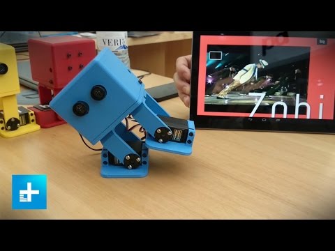

If you have access to a 3D printer, here is a low cost way to make your own walking robot.
I used an xyzprinting DaVinci 1.0 to print out the parts.
I had to see this to believe it, but this Zowi/Otto clone can walk with just 4 servos.
You can now download the 3D Cad files (STL and SolidWorks 2015) at Thingiverse:
https://www.thingiverse.com/thing:2503623
Development was posted to this thread: http://forums.parallax.com/discussion/165758
Here's a video of it walking forward and backward:
One version of head and body has nibs for attaching plastic blocks:

    Here's example code.
    There's a "repeat" line at the beginning to stop it just after centering.
    Just comment it out after you get the servos centering tweaked.
    There is also code there for the Parallax Ping module, it's eyes. It's commented out, but you can see how it works...

  • RaymanRayman Posts: 16,461
    edited 2017-08-29 02:36
    Thanks!
    I'm trying to decide if eyes are looking downward when walking. If true, would be great for detecting floor edges... In SolidWorks, looks like eyes are always level. But, video suggests eyes do look down for a moment...
    Going to print out Purple and Pink one next. Then, can have a Botto bot battle with blocks, possibly with beetles and bubbles in a bottle...
    Also trying to decide if Ping sensor from one bot can detect Pings from another...
    I think maybe it can, but not sure...
    edited 2017-08-29 02:54
    The Ping))) has to send a ping to prime it for reception. There isn't a way to make it just listen. However, you can cover the transmit transducer and pulse it to force it to listen without ultrasonic burst actually propagating.

    Nice. How do you print the head with the lego bumps? i.e. Which side is printed first (layer)?
    I think the best way might be with the bumps up so they print without supports. That's how I did the purple one. Printed one upside down before too and I think that worked OK too.
