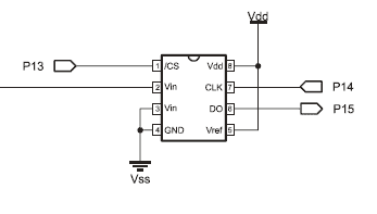

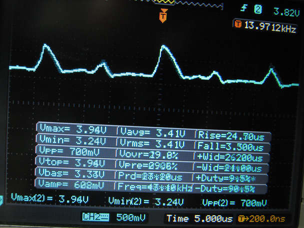

I have a control box that uses 4 MCP3208 chips. Some time ago I switched out my power supply and did not check how clean the 3.3VDC looked on the scope. Now, 4 months later things have started to act strangely. My control unit started to act up. and sure enough; the power supply had a extremely strong ripple (well over 0.7VDC), but a capacitor fixed that. Could that ripple have caused the ADC to go bad?
After doing some troubleshooting I discovered that one of the ADC is bleeding the CLK signal from pin 7 right back out through Vin on pin 2. (Note, for reference, image of ADC is a MCP3202, not a MCP3208). This bleed through did not look right. Is this a symptom of a ADV gone bad? Vin is sourced by a 100K pot. (I should have used a 10K, but it used to work with a 100K pot, just fine.)
In addition, I noticed a very strange time related phenomena. Over time, Vin slowly creeps down to 0VDC. When I set the pot to somewhere in the middle (1.6DC) and turn the unit on, at first it's all good; but about 2-3 minutes later, Vin has dropped significantly, and keeps on dropping all the way to 0VDC. It stays put at 0VDC and now to get back to 1.6VDC, I need to turn the pot to about 3/4 of a turn towards 3.3VDC. I can repeat this, by turning the unit off. I can't understand what is happening.
  • Is Vref holding steady all this time?
    I'm guessing, but if Vin was ever over Vref it may cause some internal damage that could cause /CS to show up where it shouldn't. It might be time to replace it, if the wiring is good.
    How are your grounds setup, are digital and analog on the ADC tied together? If so it might be too noisy, especially if you have more than one ADC.

    I do think there is the chance with that bad power supply in place, for Vin to have gone over Vref. Vref has no cap, and Vin had a cap that could have held a charge over 0.7V of Vref.
    All the grounds are tied together. Thanks for the helpful link.
  • MCP3208 Datasheet
    Per Microchip, any input or output that exceeds Vdd + 0.6V may cause permanent damage.
    I am guessing from the image and description that Vdd = Vref, and that each Vin source was also powered by Vdd (albeit with some time-shifting capacitance). A power supply ripple "well over 0.7Vdc" could certainly create a damaging scenario.
  • In addition to the cap, does analog Vin have a resistor to AGND?
    yes - Vin has a 0.1uF cap and a 10K resistor.
    Maybe I should have sourced all the pots with lower voltage to be on the safe side with Vin not maxing out!
    The PC power supply is really crappy. It took 15minutes to warm up and get passed its "acting-up" -- throwing large ripples phase. It would also sometimes slowly (over seconds) swing down to avg. 2.8 and back up to avg. 3.8 during warmup. At times it is good, for short periods of time. Picture taken when it is not swinging, but not good. Vpp is 0.7V!

  • You could always use the 5 V rail of your power supply with a DC-DC drop down to a steady 3.3 V.
    How many amps at 3.3 V do you need?
    There are a lot on eBay.
  • PC PSUs are designed for heavy loads and aren't spec'd for what essentially is standby mode where very little current is drawn. They could in fact be operating in a kind of "hiccup" :) mode and this may be what you are seeing. Always best to use one or more LDOs as you need them sourced from 5V and it wouldn't hurt to have separate regs for the A/D and the CPU.
