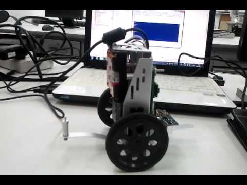

    Carol: Way to dive right in. You've certainly taken a lot upon yourself in this heady endeavor! Sometimes it pays to walk before running. A lot of people have made BoeBots balance using just a PING sensor instead of IMU or gyro/accelerometers. Might this be an intermediate step worth checking off?

    BTW, what the heck is that thing between the wheels and sticking out the back of your robot? I want to use the Ping to make this robot have some roaming behavior.

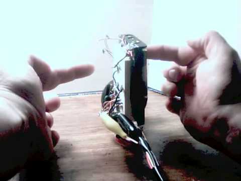

    I believe the thing sticking out in the vid that erco posted is like a kick-stand to prevent the bot from falling completely over if it gets off balance. That way it is not smacking on the floor or table if it falls. just a guess though.
    I've posted this several times, but it's neat to see how simply this guy got his robot balancing with just a 555 timer & analog circuitry, using a light sensor.
