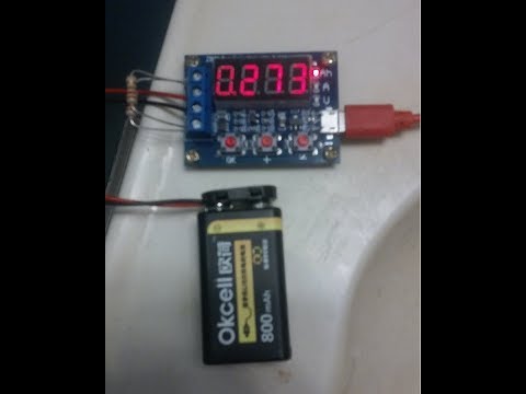

    Here's my quickie bench test. I hooked it up to a high-power motor and it popped the internal circuit (breaker) immediately. Didn't get a current reading. It did reset when I charged it for a few seconds (PHEW!). Then I put a smaller motor on (100 mA) and it ran fine. I slowly increased the load up to 800 mA and held it there for ~5 seconds and it never stopped. Not too shabby IMO.

    https://www.banggood.com/OKcell-9V-800mAh-USB-Rechargeable-Lipo-Battery-for-RC-Toy-p-1022214.html
    These "800 mAh" batteries only deliver 270, I tested two with identical results. And they weigh just 20g, half of the 40g claimed on Banggood's website, so somebody cheaped out. Banggood is offering a partial refund, so good service there.
    ZNTER's 400 mAh batteries test at 351. Mo bettuh'.
