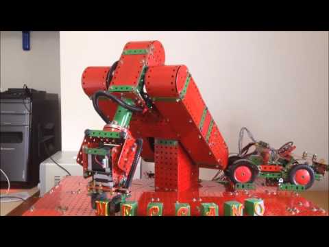

    I have a 6 axis stepper controller, have a look here at a robotic arm I designed and programmed using the boards software
    However due to the stepper boards limited input functions I would like to interface a BS2 via RS-485 and therefore be able
    to use accelerometers, GP2D02 detectors, MakerPlot and other devices in my future robotic creations.
    This stepper board expects control data such as 01 04 01 05 00 01 5F 90 FB (each byte is an instruction) and replies with similar.

  • @stuarttttt,
    looks like you are deep into that meccano thing.
    wonderful. Arm and car are nicely made.
    Enjoy!
