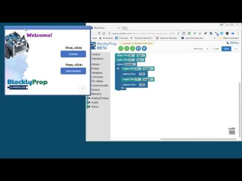

Hey all,
Here's a quick progress video showing that Parallax can download Blockly programs from a Chromebook. Our internal development team of Jeff, Matt and Jim have really done very well with this project. They've worked closely together and each of them brought a key piece to the project - our customers will be very thankful for their efforts when the Fall arrives. And very quietly - hush - Parallax is meeting all the checkboxes that presently can't be met by other educational systems. Those requirements include:

    Blockly generates C code in our system, but it's flexible and can generate just about any code you'd like to create. Up until yesterday our S3 robot as driven by blocks that generated Spin code, but today that system is also C. The compiling happens in the Amazon Web Server cloud - we've got a bunch of self-scaling servers that grow with demand. The Chromebook necessitates the cloud environment due to absence of local file storage.
    I don't think we'll be putting Spin back into Blockly. It's a simple market-driven thinking. Spin is not a language that educators use (or are told to use) and we've tried it before but only with fair results. Now that we're doing what the market wants we are far more productive.
