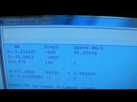

    Interpreting a useful subset of GCode is relatively trivial. The hard part is turning that into useful movement. That includes trajectory planning with look-ahead, acceleration / deceleration handling with different limits for each axis, and different step-per-inch units per axis. You need to allow for tolerances & slop when cornering with piece-wise linear segments. Then you have to execute the motion plan, paying attention to system inputs (like limits, and the pause or stop functions), and be able to resume after a pause. It gets complicated in a hurry.
    I feel like the prop would be well suited for executing the plan once you have one, but actually generating it is non-trivial. Setups like Grbl / TinyG / SmoothieBoard all do this by streaming from a host (or SD card) and doing lookahead on only as much as their buffer allows. On the older Arduino's that's not much, though the newer Due systems do a much better job because they have the horsepower.
    TinyG does jerk-controlled acceleration, whereas many of the boards are just constant acceleration (trapezoidal accel curve).
    https://github.com/synthetos/TinyG/wiki/Jerk-Controlled-Motion-Explained
    This is a great talk detailing some of the joy of implementing some of this:
    http://hackaday.com/2017/01/03/derek-schulte-path-planning-for-3d-printers/
    I think P2 could handle this as well (or better) than a single-core processor, as the planning and executing parts are inherently separate. Being able to run it as two different cores would be simpler than the interrupt-based approaches these other systems use, but it's still a complicated problem.

    What if you "compile" the G-code into binary byte codes and write them to an SD card. Then you could get rid of the G-code compiler and just execute the byte codes off of the SD card when actually driving the device.
  • Executing the plan shouldn't be that hard - Most of what I've seen produces really short linear segments that are maybe a millisecond in duration. You basically have a set of direction values (1 bit per motor) and a step count to execute over that slice. Building up that plan is the hard bit - Most of them do it by scanning ahead by some number of steps and looking for hard stops or sharp corners, because those are your speed limiters, and then working backward from them. Part of the complexity is that if you have to limit yourself to a maximum speed based on how far ahead you can see, and you're constantly re-evaluating your path with each new GCode you get in - It's a lot of extra work because you can't just buffer the entire path.
    I'd suggest doing the plan on a PC and then just executing it on the Prop, but then you can't easily pause and re-start. You need the same logic to begin in the middle of a paused path as you do to plan the path in the first place. A chunk of the complexity of the Arduino based solutions is managing concurrency - They use interrupts to service the stepper motors and do weird things with interrupt timing to make it work, and the Prop wouldn't need to deal with that, but it's still hard to get right.
  • I think parsing G-Code while running is a waste of time on the P1 or even the P2. Actually we should call them G-Strings, because that is what they are.
    My Rapman printer seems to do that, the files on SD are binary.
    Going all the way to just saving pin states for the stepper driver (like in the other thread) is on the other end of wrong, Way to big files, way to less to do on the Prop.
    But maybe there is some intermediate state to use as file format. The Idea of time-stamping moves to synchronize multiple axis of freedom makes a lot of sense to me, when running 1 COG per axis and not all of the axis in a big, interrupt using loop like on other controllers.
    Sure we need G-Code as input, that is a widely used standard with tons of Machine specific variations. Then some program to preprocess the files, splitting axis movements in different files(?)/Areas in one file and time-stamping them. At that stage some ramping, ooze, path-optimization or tool change commands can be inserted/changed.
    Now save that as a binary file with numbers as longs and not ASCII-G-Strings, so more easy to handle on the propeller-side.
    It basically can still be (optimized?) G-Code aka 'Command'+'Number', but already translated to binary for faster access. For visualization it can be re-displayed as ascii if need for this occurs.
    This preprocessing program COULD run also on the Prop, but I guess it would better be used on the Machine producing the G-Code, because of available processing power.
    On the propeller side things are now getting smooth. Each Cog runs one axis, following the script by timecodes, checking bounds/errors, notifying some master cog of its progress/errors, smooth sailing along.
    We could have different PASM for stepper/servo/actuator/driver/encoder/endstop variations for each axis, running the same binary-coded movement script.
    To show and use the multi cores of P1 or P2 this should be the right approach. One COG per axis and preprocessed G-Strings.
    1 main Cog, 1 FSRW/Fat_Engine, 6 axis of freedom, or on the P2 even 14 of them?
    And yes, I think running from SD is way better then running from serial connection.
    While running it is standalone, you do not need constant connection. Also better when running jobs frequently, you can just select them and run.

    I know this is not a G-Code interpreter, but I think it does show the power of what a P1 can do from the other end.
    I wrote this several years ago when I was trying to get a better understanding on how my 3D printer actually worked. I wanted to see how the actual speeds achieved compared to what speed you told the slicing software to have as a maximum. I needed to track EVERY movement all the X, Y, Z and extruders did. I did most all of it in PASM and it actually works quite well.
    One of the really cool things is it could easily be applied to almost any stepper controlled type CNC machine to show the exact position and speed at any time.
  • @Jim Fouch,
    nice!
    And gives me a brilliant plan to visualize my current g-code test project.
    Just take another quickstart and then I can live test my p1 against a P1 monitor. Why I hadn't thought of that one.
    thanks
