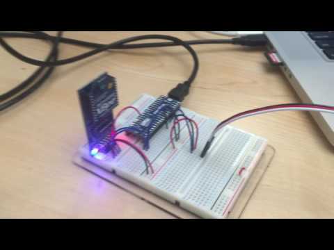

    Here is one thing I've noticed. I went to add a GPS, but it wouldn't lock. So I've started to simplify. If I power the GPS from a separate 5V supply and leave the FLIP unpowered, the GPS locks quickly. But soon after I plug the USB cable into the FLIP, the GPS loses lock. The photo shows the setup on a proto board. I disconnected all the power and signal connections between the FLIP and the GPS. Still loses lock. I probed the RF field around the FLIP with a DF loop. In the photo the DF probe is directly above the 2.2µH inductor that is located on the opposite side of the PCB and not surprisingly that is the strongest field point. The 'scope shot shows the signal there, a pulse repeating at intervals of about 0.72µS and with ringing up to about 80MHz. The signal drops off strongly with distance so I have no measure of what it might be near the GPS. I'll try other arrangements to resolve this. Those white plugboards are notoriously bad for RF work, also, switcher power supplies can be trouble around sensitive RF receivers. Has anyone else tried this?
    The GPS is Reyax RYN25AI.

  • jmgjmg Posts: 15,193
    .... I disconnected all the power and signal connections between the FLIP and the GPS. Still loses lock..
    You could try using FLiP like a wand, ie only USB powered and no connection at all to breadboard, then wave it about to see what distance separation in needed for GPS to operate.
    Ken Gracey wrote: »
    ... The GPS was mounted on a breadboard with the FLiP Module. It worked flawlessly for quite some time until I changed something. Not sure what I changed - maybe the power supply or the actual breadboard - and it never worked again.
    GPS is already somewhat marginal indoors, so adding more sources of RF energy close by, can only make things worse.
    The energy in the GPS band will be very low, but it does not need to be much to block the GPS lock.
    The SMPS on FLiP will have a broad spectrum.... :(
  • jmg, tried the experiment as you describe. GPS is fine at 6" distance in air, intermittent at 5", stops at 4". The GPS is still on the white breadboard, but the FLIP is simply plugged into USB and held like a wand.
    Then I put the FLIP in a plastic bag wrapped with a sheet of aluminum foil. I had a wire wrapped on the FLIP ground pin and connected to the aluminum foil with conductive-adhesive tape. Now the FLIP can be right next to the GPS and it still locks fine. I also tried it without the ground connection but that didn't work so well. This is a kluged setup, but I would conclude that the interference is electromagetic, and that it can be alleviated with a faraday shield.
  • So the GPS is tracking, and then you watch it fail to track based on the FLIP moving close? Does the received signal strength degrade based on the proximity of the FLIP? Or is this failure to acquire? I wonder if u-blox has any sort of software spectrum analyzer capability built-in. Some chips include this because it saves the Apps engineers a lot of time.
    KeithE wrote: »
    It might be interesting to change the frequency that the FLIP is using and see if this helps. Maybe some harmonics are falling in band and hurting GPS.
    FLiP also includes a SMPS chip, and the SiTime 5.00MHz oscillator, neither are easy to change, and SMPS spectrum will vary with load.
  • This is a kluged setup, but I would conclude that the interference is electromagetic, and that it can be alleviated with a faraday shield.
    Or some distance separation, right?

  • VonSzarvasVonSzarvas Posts: 3,593
    edited 2017-05-30 08:59
    Couple ideas to add...
    First, I took a quick look at the WaveShare GPS photo. There are a couple components by the RF jack already that would help protect the GPS antenna input from picking up noise (namely a 10ohm resistor and a ceramic that I'd suspect is an inductor connecting RF to VCC).
    That being the case, it would seem places to check are at VIN/GND and IO connections.
    The IO cable(s) is the one with switching signals, so can you replace your simple jumper lead with a screened cable? Hook the screen to GND at only one end- probably the FLiP side.
    If that doesn't solve it, you could also try:
    1. Add a 4.7uF or so cap close to the gps module vin/gnd pins
    2. Add a series resistor close to the gps module at each IO. (tx/rx I guess?). Try a resistor value 100ohm to 1k sort of range. Instead of the resistor, you could also use an inductor (20nH to 50nH) or a bead (500ohm to 1k), if you have any of those instead.

    ... I went to add a GPS, but it wouldn't lock. So I've started to simplify.
    Hi Tracy,
    In your picture you have those two cables with croc clips passing over the GPS module. The croc clips are also resting above and next to the antenna.
    Do you get an improvement if you route those cables away from the GPS module, whilst also making sure there's no large conductors (any sort of metal objects) close to the antenna?
    I'm thinking that in the pictured setup, if you "wave" a switching node (DCDC inductor) near those 2 long croc-clipped-cables, then they are quite likely to pickup noise and couple it to the GPS supply rail. In this case, maybe a low value series resistance or bead at the GPS vin, plus a cap, might be sufficient to clean things up. That GPS module can't need much current? 50mA for the antenna (if it's active?) and 30mA for the module perhaps?
    Just sharing thoughts here... I'd like to get some time later in the week to do some testing too. I like the look of your hoop-probe (look's like copper pipe! nice!). Do you get stronger signal if you rotate that 90degrees to the inductor, rather than holding it flat on the top of the pcb?

  • Ok - maybe if someone has the same issue with the Waveshare then they can try the external antenna. It's definitely a good idea to deal with the root cause though.
    5 MHz is a not a great choice for a signal to be running around a GPS receiver, so if there's anyone that can sniff for that and its harmonics, or change it would be good. You don't want anything near GPS L1 @ 1575.42 MHz.

    I did another quick setup at my desk this morning. No measurement RF tools - just physical separation and the Waveshare GPS immediately locks and provides data (inside my office, where it certainly wouldn't work before especially when near the FLiP). You can all take this for what it appears to be. As Tracy reported "your mileage may vary" by moving things around. But it works here!
  • For what it is worth, here is another data point.
    I have a uBlox GPS Module which has always worked just fine indoors.
    I have a FliP running all eight cogs active. The GPS loses lock (the blue LED stays on) if I get the FliP within about 4-6 inches.
    No electrical connection between the two.

  • If it helps the discussion, I've had a Prop Mini in continuous use within inches of a WaveShare GPS for a month without trouble.
    A few days ago as I brought the FLiP nearby to measure its 40 MHz, GPS reception went from erratic to zero. My guess was that the RFI of the FLiP is off-the-charts compared to the Mini.
    I avoided the problem by moving the FLiP a foot away and surrounding it in aluminum foil.
    edited 2017-05-30 22:15
    LeapSecond wrote: »
    Sounds like it is less the Prop, and more the Switching regulator then.
    I wonder if the Switching regulator can be improved ?
    Google finds this : "20pF in series with an inductance of 0.6nH will be resonant at 1.5GHz"
    ie some quite small caps may help.
    Addit: also varying the SMPS diode would be easy to try, I see others with lower Cj and lower Trr like SS24FL
    At least the SOD-123FL package is popular, DK shows 109 stocked hits.
