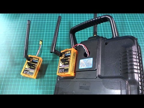

    edited 2017-05-25 00:25
    Here's a video about using an Orange TX module as a receiver.
    IMO, this channel has lots of interesting RC related video.
    I'll add any other video/links I find on the topic of hacking RC gear to this post.
    Edit:
    I haven't watched the whole video but I think it has a lot of good information about some of the RC protocols.
    There appears to be a lot more information about the receiver side of RC gear than the transmitter side.
    BTW, the first video I posted used radio modules which allow much greater range than 2.4GHz radios.
    One of the properties of radio signals is lower frequency bands have greater range than high frequency bands at a given power level. You'll often see long range systems using 900MHz or lower frequencies. The high frequency systems can send more data in a given amount of time.
