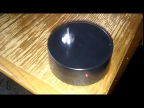

Geeky tech educational fun. 9V battery powers an electromagnet in the base to keep the PM top spinning. The only component is a switching transistor, very simple. Electromagnetic coil is slightly off-center in the case. Coil is center-tapped, actually way off center. The electromagnet is ~67 ohms, the sense coil is ~15K IIRC, connected directly to the transistor base lead.
I added an LED & 1.5K resistor across the electromagnet coil to indicate when the power is on. LED polarity doesn't matter since the pulsing DC signal generates a reverse voltage across the coil as the field collapses.

  • Seen this on my eBay page the other day, the top could use a little Sharpie marker to add some contrast. Neat little gadget to demonstrate the principles of magnetic induction.
  • How long does it run on a 9V battery?
    edited 2017-03-31 02:30
    localroger wrote: »
    Gotta be a day or more, I've run mine for several hours and the carbon zinc battery still measures 9.3V. I stopped running it continuously because it gets into such a repeatable orbit that the tip of the spinning top polishes its path on the black plastic base. I didn't want to wear a groove in it. :)
