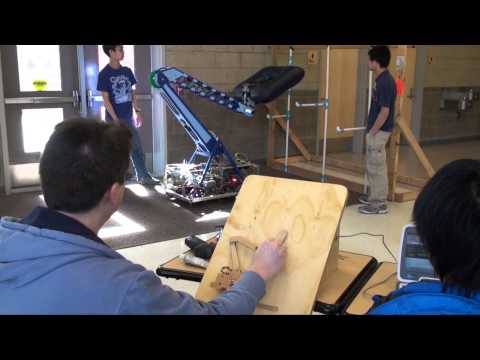

    Here is a short clip of the control system we made for our 2011 FRC robot. The controller has three pots to sense position and a toggle switch for the gripper.

  • Yes erco I am working on something similar. My robotics team uses a lot of Parallax products, so we will likely stick with that. Today, using the Activity Board we figured out how to control 4 servos at once by using 4 potentiometers. Since we have 5 servos in our other arm we need an MCP 3208 just like xanadu was saying. A friend gave me some code for the MCP 3208 although I have yet to try it out, but I have done much of the wiring. RS_Jim, I am reading the pot values by telling the program to print the value to the terminal. And xanadu I am using the Xbee that says S1 on it.
  • Anyone have any tips on wirelessly controlling 5 servos with 5 potentiometers? I am programming in Propeller C and I'm not an experienced programmer. As stated before I am using the Activity Board, but since there are only 4 analog inputs on the board I am using the MCP 3208, which I am not sure how to program. Today I tried to control a servo on another Activity Board. I used Xbees and it didn't work.
