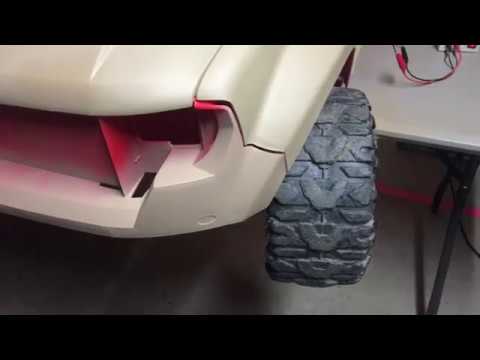

  • I had to cut the fenders a little to get clearance.
    sounds like moding a 4X4 for over size tires!

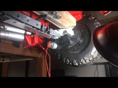

  • Here's a pic of the final drive that goes out to the wheel hub, which rides in the slots.
    Thanks, if this doesn't work out I will be scrounging around for alternatives. I have high hopes. It's a beast. I don't mean to sound like a broken record, but we aren't going far anyway.
    1210 x 908 - 281K
    edited 2017-06-13 01:25
    xanadu wrote: »
    That looks like a difficult connection to duplicate, making an adapter will be a challenge.
    Maybe if you sacrifice parts of the original wheel?

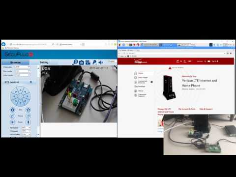

    Problem solved. I switched to Verizon, and now the rover is 4G capable. My preferred remote location is only 3G, but I guess it can't stay there forever, so this makes sense in the long run. I ended up with this device. I have unlimited data, which is throttled at 10GB and again at 20GB. I'm trying to hit those caps in the first month to evaluate the speed. It's cheaper than the AT&T plan, and they threw in a $200 gift card :)
    I was skeptical. The rover has more than one network device, I was going to have to put a switch on it anyway. The Mifi size isn't bad, and there's plenty of room for it, so let's move on to the good stuff. There are a lot of external antenna choices, and it has an internal lipo backup battery (because you can connect a phone and/or Verizon alarm system to it).
    Interestingly, the Verizon Mifi device runs on 5V. The power turns out to be only slightly more than the AT&T USB modem. I connected the Pi, a desktop and a laptop to the Mifi and made them all do stuff. 0.200 mA idle and topped out around 0.450 mA @ 5.2 V when busiest. I don't know how long it will run on the backup battery, but I'm sure it's enough for a short brownout caused by the rover's motors.
    On my office desk it shows 4 of 5 bars for signal strength. I ran some tests. Pic #1 is a speed test from the Pi, connected via Ethernet to the Mifi. Pic #2 is my home PC pinging the Pi, through Hamachi, over the 4G link.
    VNC works like a charm. 99% of the work I do is over some remote connection, and it's better than what I'm used to. I'm able to run 1280x1024 w/ 24 bit color depth. It's responsive and smooth. You could program using the IDE, drag windows around, FTP large files, and whatever else you want. I know I can squeeze some more signal out of it when it's outside.
    I was promised a public dynamic IP, but they didn't mention a $500 setup fee for it. At least they knew what I was asking for, unlike AT&T. One of the Verizon techs called me today and said it would also have to be a static IP. I would rather not have a static IP, and $500? lol... It looks like we're stuck with Hamachi. I wish that the Mifi had some kind of endpoint on it. If you Google Mifi hacking, you will find all kinds of cool stuff, but I'm not going to mess with it.
    The only problem I see with it is the camera. When I was using the Pi as a gateway I could control the camera over Hamachi. Now I'm stuck with the camera uploading video to the cloud, and using the web browser on the Pi to control the PTZ. I'm starting to feel like this rover will never be finished, so I'm going to start accepting what I have and moving on.

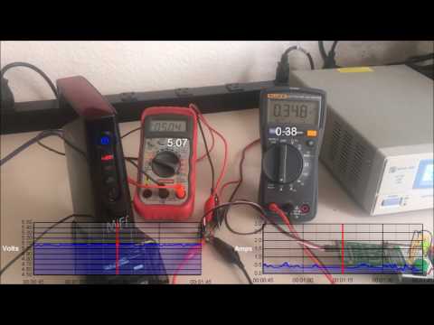

  • Here is a visual representation of the power requirements of our bulky, yet efficient modem/router/switch. This thing will not be an issue. I left some DMMs in for the most accurate representation.
    I built a data logger using the Propeller, it's far from perfect, but plenty good enough for this. Here's the code. If I were to continue using it I would add floating point math. Dashware is currently doing the floating point math. It tries to interpolate between the 1 second readings, and it causes some weird effects that, well, suck.
    The video overlay is done post production using Dashware. Dashware is now free. When you use a custom data logger, it can be a real beast. It's not part of the rover project, but I thought it would be cool for the next few videos. Bottom line, if you need to overlay data on a video, Dashware is a solid contender.
    My logger also adds a running mAh tally, I forgot to include it in the video, but it's the 4th column in the CSV. Apparently this forum does not allow CSV, so it's attached as txt. Uh, that doesn't seem to work and locked up my desktop icon lol... Way too long of a day to start troubleshooting a new issue. Here it is in pastebin.

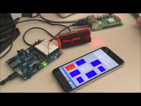

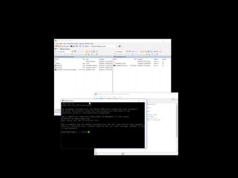

    Thanks guys. Today the fun went exponential. I reconfigured the Rover's Hamachi client to host a gateway, and have full access to any IP the MiFi hands out (or static IP) on the Rover's LAN. The previous VPN was a mesh network, which is okay for 2 devices, but we need to get the IP camera online.
    It's super simple for other people to join the Rover's LAN. I will harden the the RPi side before going live, but I would like to keep the VPN available, and simple as possible for other people to join. It couldn't be easier.
    The best part is speed! Tldr; RSRP -92dBm RSRQ -12dB. Ping: 32 bytes 56ms!!!
    I tried to keep the video short. It didn't work out. This isn't wireless programming, it's long range UGV programming. The Raspberry Pi plays a big role. I would love nothing more than to strap a modem directly to the Propeller, but this has much more to offer. On Rover this size it's the perfect fit.
    Edit: LTE cap is now 20 GB.

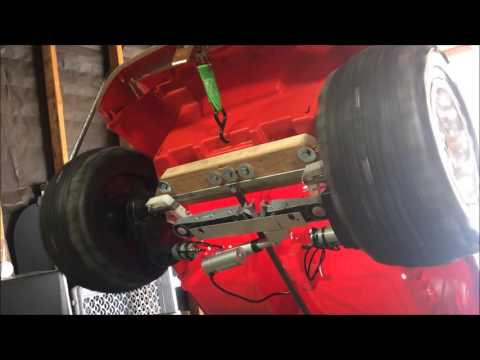

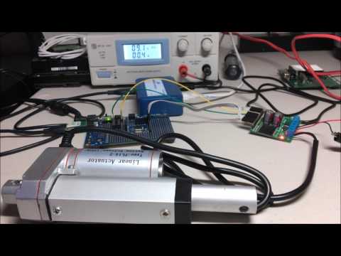

    I moved the steering actuator, gained some ground clearance, and it no longer pulls on the plastic chassis. The placement is final, geometry is final, I can move onto steering feedback. There's a few options to choose from, I'm testing them all.
    The Sterilite box I chose was too large because they listed the exterior dimensions as the exterior dimensions. I was hoping to put some more electronics in this weekend, but there's nowhere to put them, yet.

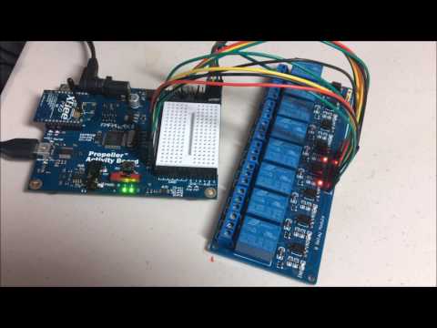

    I made a little python program https://pastebin.com/g3w5qadG that has some buttons and send serial commands. The rover will be remote control, semi-autonomous and support fully autonomous modes. So I need some way to control it, and change those modes. For now I tried this -
    It works really well!

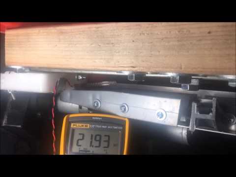

    Speaking of which, I am monitoring both now. There's also a Python program HTML scraping the RSSI from the modem, 0 to 5 "bars".
    It's very cloudy and dark, and the battery voltage is going up! The camera is not installed, nor are the motors turning, but it's good to know we can at least keep communications up on a cloudy day.
