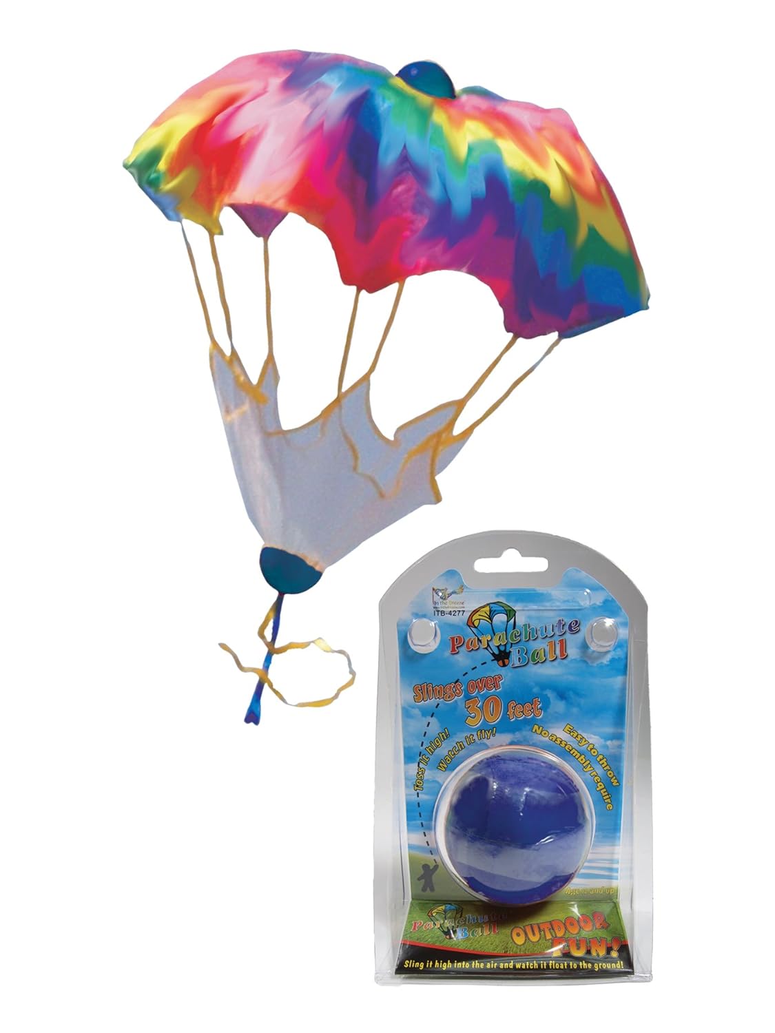

  • I imagine one of these ball parachute toys launched from the quad and connected by a thin stainless steel cable with a length 2x the diameter of the quadcopter to prevent tangling or severing by a blade.
    I think that a "toy style" parachute doesn't match with V3.....
    V3 needs something unique. A new parachute design taking in account various parameters....
    Reliable parachutes cost a fortune and you can't know in advance 100% your real needs.
    After a lot of research I ended up that a very good suggestion was in this web site : Richard Nakka's Experimental Rocketry Web Site
    I followed the steps of construction and I'm very happy with the result. ....
