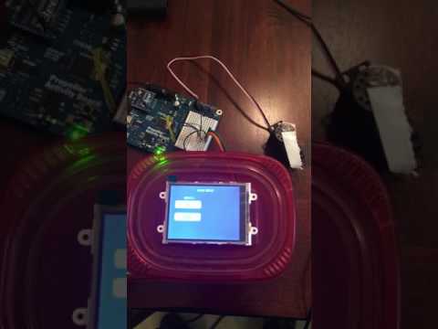

It has been a while since I posted my original "I need help" message, but, as I have found time, I have continued to work on getting the connection between my 4D Systems uLCD-32PTU touch display and my Propeller Activity board to work. Based on Duane's comments, I went back and tried to start with the basics (i.e. get the communication between the LCD and the PAB to work correctly). I used the Parallax Serial Terminal to report a message and I used the LEDs on the PAB as an output to report a button press. This sort of worked, and sort of did not work.
I originally downloaded Mathew Brown's Visi-Genie object from the Object Exchange to use as the basis of the object to communicate with the LCD. After I could not figure out the problem, I went back and re-read the 4D Systems paperwork and re-read Mathew's code to better understand it. 4D Systems seems to have a lot of App Notes that were pretty helpful to me in better understanding how to communicate with the LCD.
My original program was calling the PollReport method in the Visi-Genie object. If I understand the method correctly, if it was not commanded to wait, it would roll right through the method, possibly detecting a button press or possibly not. I believe this depends on the speed through the object and the time it takes for the button to be pressed on the screen. Sometimes it seems like it would report that the button was pressed, other times it would not.
The 4D Systems information says that a button can be configured to report a message when an event had changed, and this is exactly what I wanted to do. I added a method to wait for a reported event. This is a simple repeat loop. The main object looks to the report event method in the Visi-Genie object and waits until a message is received from the LCD. Then, the main object processes the received event based on what button was pressed.
The next step will be connecting the XBees and communicating between 2 activity boards. I now believe this will work better since the Visi-Genie object is detecting the button presses more accurately. Thank you again Duane for your suggestions.
Attached is a quick, and very rough, YouTube showing the setup and sections of my program.
