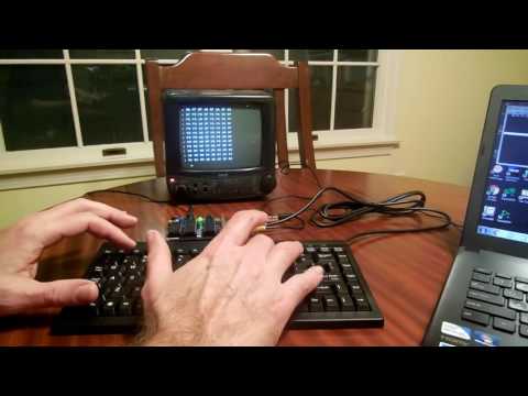

Over the weekend I built an L-Star kit I bought from Jac Goudsmit. It uses the Parallax Propeller to emulate a ROM chip, a video display, a keyboard interface, and serial port. It's a neat little kit that I thought the Propeller forum might find interesting.

    Building retro-computers is a lot of fun and this is a good way to ease into the hobby as it is nearly goof proof. It squeezes a lot of functionality out of three chips making it easier to use than something like the Fignition or Micromite which have a similar level of complexity. Because it emulates an Apple 1 there's software you can find online, but it is also a good introduction to assembly programming because of the onboard Krusader editor/assembler for the 6502.
