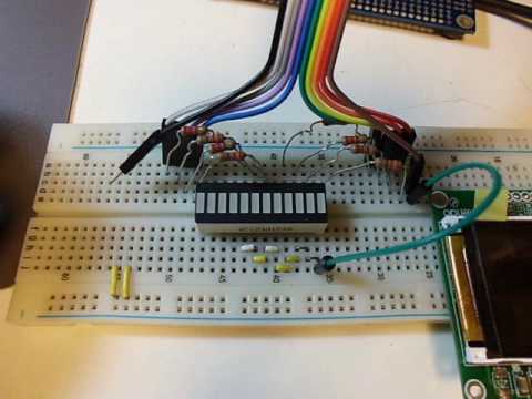

  • Hi D.P.
    I trued your latest code.
    BLINKEN <-- Starting LED blinking
    STOPEN <-- Blinking stop but some LEDs still on
    BLINKEN <-- Re-starting LED blinking
    I retry BLINKEN & STOPEN.
    Sometimes all LED are off.
    Why?

    caskaz wrote: »
    Hi D.P.
    Why?
    Hi caskaz,
    I've tried the source a bunch of times and it works correctly, will download the lastest 4x5 spin and extend and try again.
    I will update this post with results.
