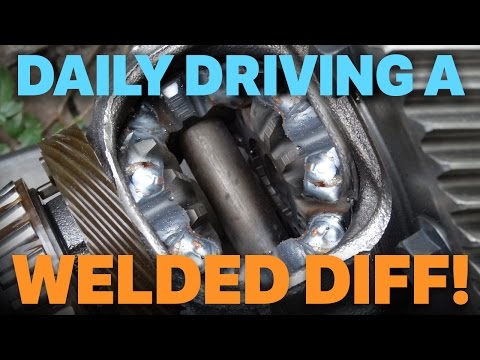

Barely related but fun IMO: For the drifting set, scrubbing is used to advantage.
