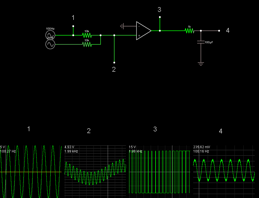

    Are you looking for noise-shaping techniques as used in audio DACs? You can use 8 bit PWM at 192kHz
    and get (nearly) 24bit audio. Its indistinguishable from magic, but requires a DSP for higher order filters for
    best performance - however there is a double-integration filter that gives you most of the advantage
    of noise-shaping from even lowly processors.
    Perhaps this thread is relevant? forums.parallax.com/discussion/148280/prop-sound-quality-question

  • If you heterodyne a control signal of 1kHz at a 16-bit resolution with a fixed 20kHz, the resulting PWM will be "up converted" to 20Khz with frequency components of 1kHz, 19kHz, 20kHz, and 21kHz. The caveat is that the control signal AND the fixed 20kHz should be a sine wave. Doing something like this, that 1.3GHz becomes a substantially lower number to work with. ... but all of this depends on the application.
    Note: The Simulator only goes to 25kHz, but in order to "see" the wave patterns I used 100Hz and 2kHz for my control and fixed frequency in the attached image.
