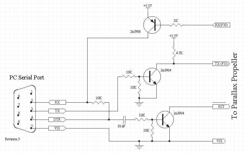

i just bought a 40 pin dip propellor built the circuit from the serial contector to the chip as per the schematic in the manual. i have a usb to serial cable so im using the serial schematic in the manual. ive checked triple checked all my connections, now it recognises the chip and says all is good but i cant get any response from any of the i/o pins. i bought 2 of the 40 pins and tried them both but nothing. anybody have anything i can do to try and solve this? thanx and whats the difference between prop1 and 2?

  • Sorry but I'm unable to post pics right now. My power supply is 3.3v I have checked this and double and triple checked these connections. The only thing I am not too sure of is the pc to bs2 serial circuit. Its connected properly according to the schematic on the help page. I've had a friend also check double and triple check these connections. Does anyone know how good the schematic for this serial connection is ? I mean it recognizes the prop says the code was loaded but like I said no output.So maybe thats not it. Im thinking about buying the prop plug to eliminate a chance of problem there but otherwise I'm at a loss
  • @BarryFaux
    re: pc to bs2 serial circuit.
    Do you have a link for that schematic?
    This is the serial schematic for the propeller chip?
    http://forums.parallax.com/discussion/download/41153

  • BarryFaux wrote: »
    Where does BS2 come into play? Which help page are you using?

    If the code is downloading correctly, then the problem is likely your program. If the downloader is not working (programming the propeller) then there may be circuit problems.
    You need to take the time to post some photos, schematics, and code (plus describe what you are using - Windows/Linux/Mac, PropTool/SimpleIDE/PropellerIDE/bst/homespun/GCC, etc).
    Otherwise we are just guessing.

  • it's working, i made a really dumb mistake is all it was. I mixed up the pin out numbers with the actual i/o numbers. All is good now so thanks everyone for the help ,im sure ill be back.
