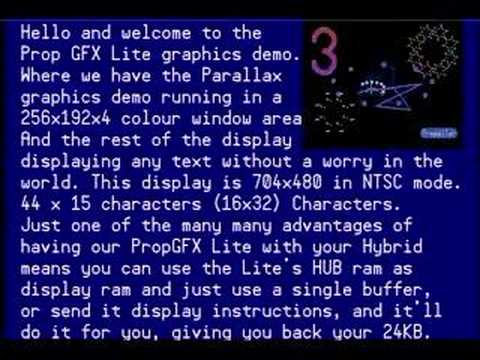

  • Using PAL you will not be able to display 720 pixels horizontally. There are three problems...
    1) PAL, at that resolution, uses a 13.5MHz pixel clock. The active line width of PAL is 52us which limits you to 704 pixels wide.
    2) The bandwidth of a PAL signal is limited to 6MHz which will severely affect your horizontal resolution. Also, sitting at 4.43361875MHz you have the colour subcarrier which, if you are unlucky, will alias quite nicely with your pixel data.
    3) The Propeller is not able to generate PAL. It can manage something which is like PAL, but it isn't PAL. Many displays will render it OK but with some artifacts. The problem is that it can't generate the 4.43361875MHz subcarrier accurately.
  • (pressed POST too soon)
    720 pixel wide text implies around 90 characters per line. Such text would be unreadable on any TV fed with composite video.

    I'm fairly certain we did a PAL version of this at 720x576 resolution but here is the NTSC version for your amusement
