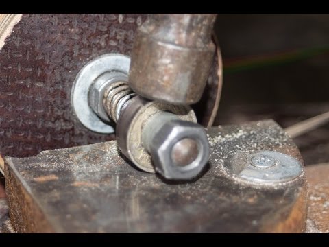

    Hal, erco and xanadu, thanks for the feedback. And right, I don't plan the servo picking up the entire weight of the hammer. I should have explained more. I'm thinking of something like this below. The servo will rotate (speed is not a problem I don't think. In fact I want it to make a full rotation one to two seconds. But I certainly don't want to make the motor spin as fast as this ring maker. I like the simplicity of this design.)
    Xanadu, I like the solenoid idea too. But with the solenoid, I would have less to build! I can actually do this "on the clock" at my workplace, so the more I build it, the more parts I get to order, the more fun for me! lol
    Hal, I like your suggestion. So lets say I get a servo that allows for 7.2 volts. I wire the stamp up as normal. Including the white and black wire signal to the servo from the stamp. The red wire goes to positive on my 7.2 volt battery pack. Where does the negative of the battery pack go to at this point? Does the black wire go to ground on the Basic Stamp?

  • Erco/Hal, I was thinking of this too. If I design this correctly, with a spring on the hammer, my goal will be to have the hammer hit the bell, then the spring will prevent it from resting on the bell. It's probably going to take some trial and error to keep it from bouncing and hitting the bell twice. I only want it to strike once per cycle of the servo.
