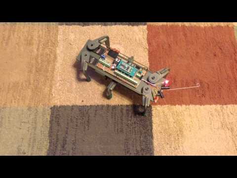

Stamp Bug 2 type "bot" - 3 servo, hex crawler

Applying what I learned building the "Boe-Bot",
most of the program routines are from the, "Robtics with the Boe-Bot" manual, version 3.0 by Andy Lindsay.
Copyriight by Parallax Inc. Some of the sensors and electronic components used
are from the "Boe-Bot" Kit from Parallax Inc.
It was a big help for the start of this project to review pictures of the "StampBug2"
and the bug's original Basic Stamp program. Kudos to the user's of this forum for those posts.
Of course, it is those same post's that reminded me that I wanted to "play" with one some time ago.
The body and legs were cut from hobby wood (bass) obtained from a local art store.
The legs were cut to include the OEM interlocking horizontal to vertical joints.
I don't have a pattern for them to include with the post, I drew them directly on the wood
itself (should have traced them out first, before I glued them together). The bolts, nuts, spacers,
and washers were obtained at our local hardware store.
The body was painted a olive green color.

I used the Basic Stamp 2, with more memory and
variables, the walking routines are written out
in sub-routines, making them easy to follow.
The original program actuated all three servo's at once for a nice smooth walk!
It seems the generic servos I used may be current hungry?
When operating the three servos at the same time,
it draws the voltage down on the batteries causing the servos to work erratically?.
Same for the Basic Stamp2, so I added the separate 9 volt transistor battery for the BS2,
and actuate only two servo's at a time. (The fix worked.)
As a result, the walking routines move the left and right legs separately, which slows the bot's walk.
(I really wanted to actuate all three servo's - for fluid operation.)
The center leg servo works the hardest and must be continually actuated to keep the right or left
side from drooping back down. I may try different servo's in the future.
The "bot" also seems to "crab" a bit, on hard surfaces, one direction, and on the rug, the other direction,
with no change in the servo parameters. Maybe better gripping feet, or shorten the stride may help?

The project was fun and a great learning experience, being my first home built "bot".
Things learned and would do different in the future:
- The home soldered "carrier board" with screw terminals is fairly heavy, solder directly instead. Use a smaller 5 volt regulator, 100 mA
would have been adequate.
- Make the "bug's body wider, to accommodate the Parallax Board of Education, or the Super Carrier Board!
- Use the Board of Education, or the Super Carrier Board rather than making my own, "carrier board".
- Use a higher quality servo.
- Maybe stay to the original idea, keep it OEM, using the tactile navigation - feelers.
