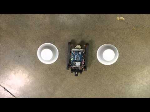

  • Sharing Encoder Modification for ActivityBot equipped with Tank Tread kit (pictures included).
    The goal is to use the drive gear teeth as an encoder wheel.
    Actual modifications are as follows:
    1. Rotate the drive servos so the drive shafts are on the forward side of the ActivityBot chassis
    2. Drill two 7/64 holes on the servo mounting plates, mount encoder with one spacer
    3. Mount encoder assembly upside down with cables facing forward with two spacers
    Parts list:
    • 2- encoders
    • 2- encoder mounting plates
    • 2-encoder cables
    • 6- nylon spacers (these are the only additional parts needed)
    Steps:
    2. Join the two mounting plates by using the encoder screw
    3. Offset the mounting plates so the encoder locating pin hole is half covered
    4. Drill a 7/64 hole through the bottom plate
    5. Align the mounting plates so they are no longer offset
    6. Using the bottom plate as a guide, drill a 7/64 hole on the other mounting plate
    7. Separate the mounting plates
    8. Using two nylon spacers between the mounting screws and the encoders, install the encoders onto the mounting plates using the new holes for the encoder locating pins
    9. Using the remaining four nylon spacers between the mounting plate and the servo, mount the encoders upside down below the drive servos with the cables facing forward
    10. Connect the encoder cables to pins P14 and P15 as usual
    11. Run the Test Encoder Connections program. You may have to move the encoder mounting plates as far down as possible before tightening the mounting screws
    12. You may have to adjust the tank tread drive wheel to minimize out-of-round or wobble
    13. If they encoders test okay, run the ActivityBot Calibrate program without the rubber treads
    14. When done calibrating, install the rubber treads and load a navigation program to test your new encoder-enabled ActivityBot with Tank Treads!
    Note: To try to compensate for the encoder loss, I had made some manual adjustments to the drive servos via the adjustment pot, so I had to do some minor fine-tuning to reverse my manual adjustments. Since the servos are now forward on the chassis the adjustment pot screws are easily accessible.

    That is a genuine ActivityBot with Tank Treads addition, and well done too. Good work, mcarter.
    How well does the encoder setup work for you? The theory looks right, but how does it work in the real world?
    Will it do the F8 challenge? Video would be awesome..

  • Hi Ttailspin,
    Thank you for your feedback, the F8 3/10/16 video is available here:
    MC
  • Very well done!
    Ecro should be amazed!
  • Very nice, mcarter. Looks like your encoder system works great.
    If you posted that video into the "ercos figure eight challenge" thread, it would for sure take first place for neat and tidy,
    You would, of course, be showered with rewards of great praise and honorable mentions..
    Keep up the good fun.
    -Tommy
  • Thanks Publison and Ttailspin for your feedback.
    This is our very first posting on Parallax's forum, and our purpose as a high school robotics and engineering class, is to share what we have learned using the ActivityBot within our abilities and resources.
    Our hope is that the encoder modification instructions and pictures contribute to robotics students around the world.
    Special thanks to Ttailspin for suggesting an F8 Challenge video, proof of concept is essential after all.
    mcarter
