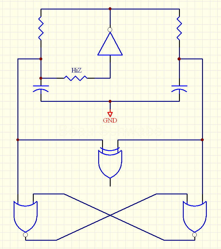

  • There are many different ways to define a PWM signal and how it can relate to a complementary or phased PWM signal, but all methods that I have seen so far rely on the processor clock to accomplish the PWM. Is there any thought in a dynamic pin driven approach that is separate from the processor clock?

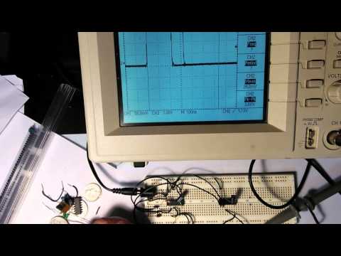

    Here is an example ... you have two inputs that could be quadrature, but for the sake of the example lets say that they are not quadrature, but at the same time you want to detect the precise lead or lag between the two pins, ... ok, so a simple complementary nor gate configuration can determine what leads or lags, and here is where the PWM comes in ... by XORing the two inputs you can detect the amount of error or difference in lead or lag by way of a PWM from the output of the XOR. If you "gate" this operation with a processor clock you get unwanted propagation delays from the clock cycle that degrade the dynamic quality and sensitivity of the circuit.
    The Video I have here uses a very similar circuit to the one below with a classic Wheatstone derivative. Although the video suggests a metal detector approach, the principle can be applied towards MANY other sensor arrangements as well as signal comparisons. ... just to give an idea, the sensor used in the video is a chip inductor that measures 1mm x 1mm x 2mm in it's physical size. The amount of inductive deflection by an external metal or magnet source is less than 10% of the inductors value.
    Are you asking here for another pin-mode ? - Along the lines of an ASYNC XOR, or a Configurable Logic (simple gates/FF) as found in Microchip and SiLabs MCUs ?
    I think Async Invert (for Pin oscillators) is there already, but a Async XOR could certainly be useful.
    I have seen clever things done with P1 Counter PLLs (missing on P2) and they allowed Async signal generation, and even phase sweep by deliberately wobbling the reference so lock was never settled.
    This allowed external XOR approach, and by measuring over a large number of samples. and assuming the clocks were never locked, you can calculate the fractional times, down to sub ns.
  • "Are you asking here for another pin-mode ? - Along the lines of an ASYNC XOR, or a Configurable Logic (simple gates/FF) as found in Microchip and SiLabs MCUs ?" - you have the right idea
  • cgraceycgracey Posts: 14,320
    Async XOR could be done in the pad, outside of the synthesized logic.
  • Async XOR would be fantastic, Chip
