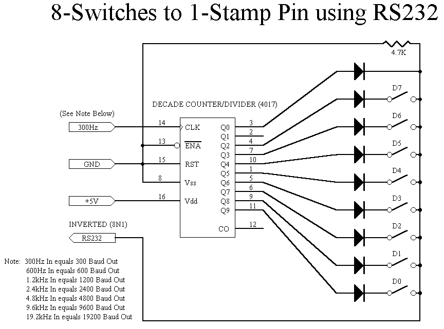

As part of a weather recording project, the task at hand is to read 8 reed switches (1 or 2 will be closed at a time) to determine the cardinal or in-between wind direction. I do not have many pins left so 'if ina[ ]' statements will not work.
I've slightly considered using a 8 channel ADC or a multiplexer IC but thought that a ? here on the forum might lead to other approaches and probably the best answer.
So the ? is, How can I read 8 inputs w/ the least prop pins used. Speed is not an issue and the input will only be on or off. The propeller will display or save the direction.

  • Beau SchwabeBeau Schwabe Posts: 6,568
    edited 2015-12-05 03:35
    Why not a continuous RS232 stream? A 555 timer, a 4017 Decade counter, Nine diodes, and one resistor, and you have a continuous 8N1 serial data on one pin you can read whenever you want.
    Note:(add a resistor and capacitor for the 555) ... it is possible to wire a 555 as an oscillator using just one cap and one resistor. See link-->(http://forums.parallax.com/uploads/attachments/41345/82173.jpg)
    Note: The image says "STAMP" ... I put this circuit together more than 20 years ago before the Propeller existed for an Alarm Keypad to send the Pressed keys over a distance without having to dedicate a micro processor at the location of the keypad.
    You could also get away with using only 2 lines on the '165 if you added an RC circuit on the load pin and connected the clock directly to the serial shift clock and through the resistor to the load pin. Loading the parallel data would be done with a long low pulse, clocking the serial data out with a short low pulse.

  • jmgjmg Posts: 15,182
    kwinn wrote: »
    Those tricks works best on parts with schmitt trigger control pins.

  • The amount of information returned is almost overwhelming. At least 9 different ways of doing this have been presented.
    THANK YOU!
