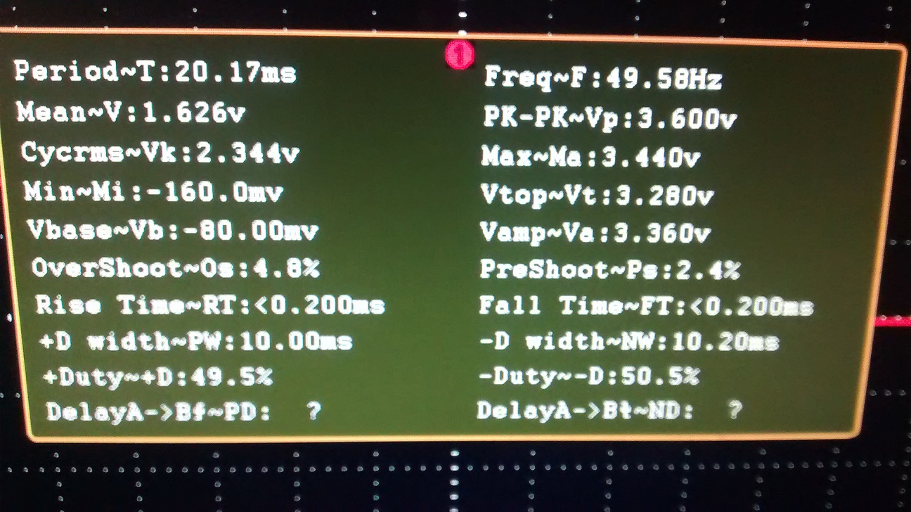

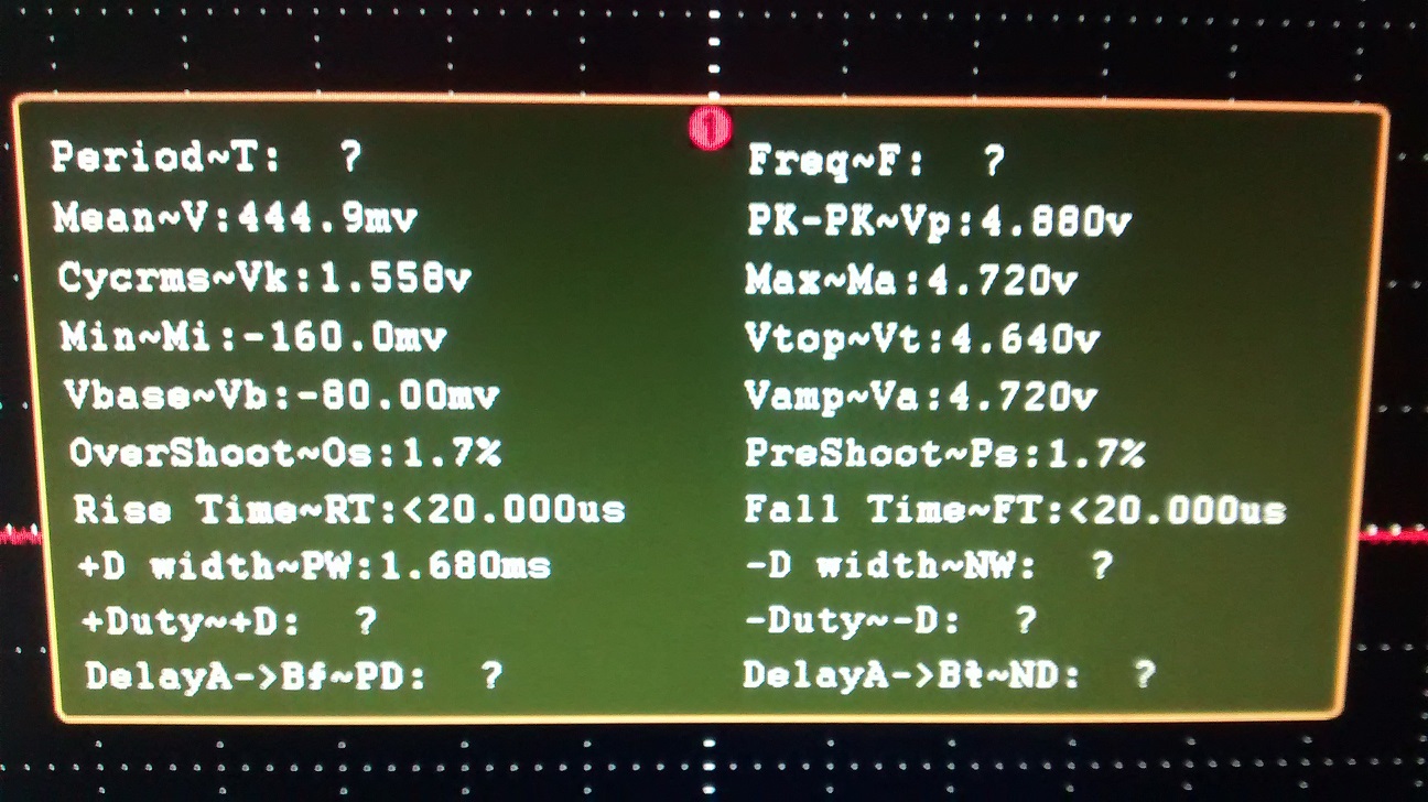

I'm trying to connect my Raspberry Pi 2B to my HB-25 with no luck (so far)
I tried connecting my Pololu MiniMaestro24 and all works well.
I then replaced the Maestro with my Raspberry Pi (no other wiring changes) and nothing (scratched head)
The Meastro has its down windows app which is nice and easy for testing where on the Raspberry Pi I wrote some Python Code which is below
import RPi.GPIO as GPIO
GPIO.setmode(GPIO.BOARD)
GPIO.setup(35, GPIO.OUT)
p = GPIO.PWM(35, 50)
p.start(50)
Basically the code above is using pin 35 at 50Hz and 50% Duty Cycle. I know this is all good for I connect my oscilloscope and saw the PWM signal from the Raspberry and as I change the Freq. and Duty Cycle the reading on the oscilloscope corresponded. (scratched head again)
I then asked my oscilloscope to give me all the info on the signal it was seeing the the results are below (screen shots attached)
Maestro
Raspberry
This is were I get in a little over my head.
Can somebody have a look at the stats and well me where the problem maybe ? I notice the Max~ma Voltage is down from 4.72 to 3.6V and was thinking maybe this is too low for the HB-25 and PK-PK (peak to peak) is 4.88 compared to 3.6V are these voltage values too low for the HB-25 to pickup ? or am I looking in the wrong area ?
    That's much too high of a duty cycle. You want it to be 7.5%.
    The HB-25 behaves a lot like a CR servo. A 1500us pulse will stop the motor and shorter pulses will cause the motor to move one direction and longer pulses will cause the motor to turn in the other direction.
    It would be a good idea to practice with a normal hobby servo since the HB-25 responds to the same sort of pulses.
    The HB-25 should work fine with the R Pi's 3.3V logic. A lot of us use the HB-25 with the 3.3V Propeller.

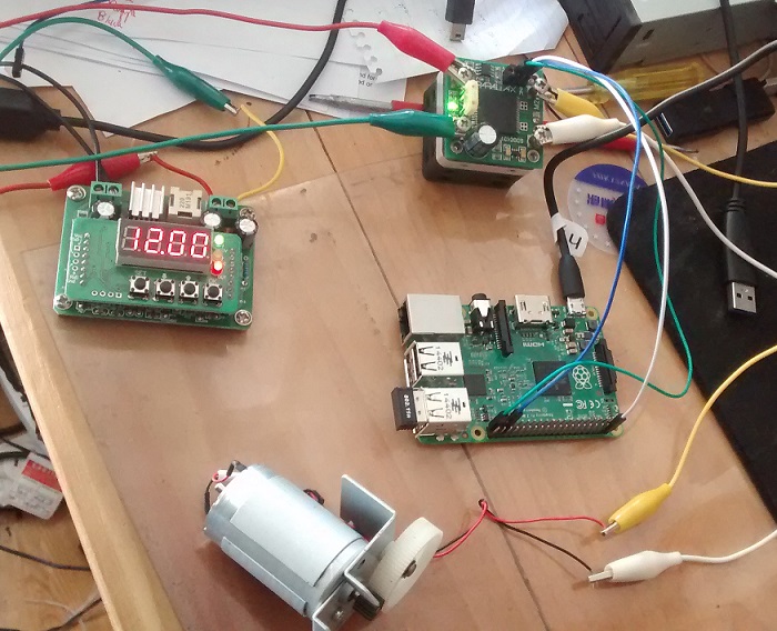

    I have attached a picture of the setup below. I have removed the 5V white wire going to the RPi from the HB-25 (R pin) for it makes the Pi freeze.
    I have also measured the voltage across M1&M2 (outputs to motor on HB-25) and nothing. When the Maestro was working I measured 11.5V
    frogmore.com.au/Setup_hb25_RPi.jpg
  • Also just tried connecting a servo to my RPi and it works like a charm.
    Feeling lost.
    edited 2015-11-26 16:31
    That green alligator clip sure looks like it's touching one side of the 25A fuse on the HB-25. When I add a similarly sized clip to my HB-25, it creates a short between the fuse and the ground.
    Edit: This doesn't explain why it works with the Maestro.
    Could you also upload a photo of the Maestro connections?
    It looks like you're regulating the power to the HB-25. I would suspect a power supply issue except it doesn't explain why it works with the Maestro.

  • Thank you Duane Degn, and Loopy Byteloose for your replies. With your help I worked it out and yes some more reading.
    I was a little high in my Duty Cycle,
    using 100Hz Freq my Duty Cycle need to be 10 for 1ms pulse and 20 for 2ms pules with 15 being 1.5ms and neutral.
    I think the Raspberry Pi is a little out for I need to use 14.6 to get a reading of 1.5ms on the oscilloscope plus the HB-25 backs this up by stopping the DC motor. Where at 15 I measure a duty cycle on the oscilloscope of 1.6ms plus the motor turns clockwise slowly.
    All good now I know the tolerances and this gives me something to work with.
    Also worth noting looks like I will need to get a dedicated PWM daughter board for the consistency of the PWM signal when I start placing a load on the multitasking OS becomes a little inconsistent and I see the motor moving a little from time to time.
