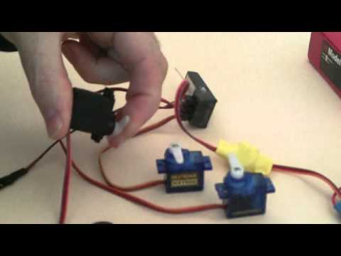

So those things actually do work! Pretty dramatic demo. I just ordered ten small cores for $3: http://www.ebay.com/itm/22mm-x-14mm-x-8mm-Power-Transformer-Ferrite-Toroid-Cores-Green-10Pcs-GY-/262033919263

    Some of that explanation didn't make sense. He said something about the HXT900 servos being sensitive to noise on the PPM control wire but I doubt the ferrite core is doing anything with the signal wire.
    I hope someone who knows more about this sort of stuff jumps in but I thought adding the ferrite core resisted changes in current so it smoothed out the current spikes of the digital servo.
    It's still a good trick (if you don't mind a big metal ring added to your project) but it would be nice to learn how it reduces the jitter.
    I'd also like to know if there are any negative side effects from using the torriod. What happens to the voltage levels as the ring inhibits the current from changing? It would be interesting to compare oscilloscope traces of both the signal lines and the power lines, with and without the toroid.
    It seems like the majority of servo jitter problems are caused by power supply issues but not all jitter is caused by power supply problems. Servo jitter can also be caused by bad pots.
    Those HXT900 servos have (IMO) low quality pots (I don't know if they're worse than other servos but I don't think they last as long as they should). I have to replace servos on my small hexapod every so often because the pots wear out. They usually wear out in the "home" position since the wiper rubs this area of the resistive film more than other areas. As the pot starts to wear out, the servo has a harder time finding its correct position which can cause a small jitter. Once the jitter starts, it becomes a destructive feedback loop as the increase in jitter wears the resistive film out even faster than under normal use.

    Isn't the "magic" the fact that the ferrite is extremely permeable?
    A couple of turns is enough to act like a low pass filter, and as mentioned it's great for pushing the noise floor down, while leaving the signal intact. More turns would distort the signal, due to hysteresis impacting it more directly.

    By adding a Ferrite core you effectively increase the inductance of the wire at the location of the Ferrite. More turns = larger inductor AND/OR larger Ferrite core = larger inductor.
    An inductor is always in opposition to a voltage change (think like a spring or shock absorber) , so by adding inductance, any sudden spikes are attenuated.
    You could just as easily add an inductor in series and get the same result, but think about it for a moment, the construction of an inductor ... With an inductor you have the advantage of multiple turns on a small core ... with the method described in the top of this post you have a disadvantage of a few number of turns around a large core ... either way you slice it your increaseing the inductance to the wire by a specific amount. The aspect ratio of core to wire is all you are changing here.
    ... Rather than just throwing some value at the problem, I'm a little more OCD than that, we should really understand what it is we are doing and WHY it works when we do it a particular way.

  • This is a little late but an inductor in series does perform like a low pass filter, but since inductors resist current change, they produce voltage spikes.
    Generally, you'd want to have a capacitor in parallel with one end tied to ground and the other tied to the power line. With a cap in this configuration, it'll be a low pass filter and it will provide instantaneous current since capacitors resist voltage change.
    Ideally, you'd want to use both of these with the inductor in series driving (before) the capacitor in parallel. The value of the inductor should be substantially lower than the value of the capacitor (you're wanting an overdamped circuit but trying to get close to a critically damped circuit).
