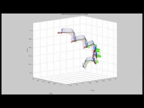

I've recently put together a very simple 3d engine for the propeller, and using a 2125 accelerometer and compass module, I was able to control the camera rotation of the 3d graphics. I was wondering what options I might have to add in full motion control so I can move the camera as well as rotate it. I figured this sensor looked like it might be useful for some of the sensor processing, but I didn't see that it could calculate displacement, so I wondered, has anyone worked with something similar? I'd like to hear what you used so I can see what would work best. Thanks!

  • JasonDorie wrote: »
    You could extract the camera element from a Wiimote and use the output of it as a cheap motion-capture setup, like this:
    There's code to do this for the Propeller. IMO, it's very cool.
    I was amazed at how well the cheap MPU6050 modules worked with the I2Cdevlib code. These modules are are just a few dollars on ebay. I didn't use a magnetometer but even without a magnetometer the yaw heading stayed very consistent.
    The BNO055 sensor is supposed to be good for this sort of stuff. I have one but I haven't played with it much.
  • This demo takes 1 cog for the sensor reads, and one cog for the IMU / FPU:
    This is the IMU code for the upcoming Elev8 flight controller. I internally use double integration of the accelerometer data to compute vertical velocity and fuse that with the altimeter readings so they correct each other. Works reasonably well, but the altimeter is a (more or less) fixed reference, which is what you need to make it work.
