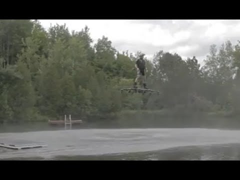

I found short animated GIF of this thing taking off one a webpage. (I can't figure out how to link to the single GIF so I removed the link.)
Initially I thought it was faked with a crane of some sort. After looking around a bit, I'm not so sure it's fake.
Here's the Webpage for the board.
Here's one of several videos I found.
There are a couple of photos of the board in the HackedGadgets forum.

  • Rough guess that the six motors would have to produce 40 lbs of thrust each. Is that possible? You'd have to carry the batteries in a back pack and spend a day charging them!

    There are 8 motors on the thing.
    I'm been told by several reliable sources, brushless motors can be submerged in water without harm. They should be rinsed with clean water afterwards but brushless motors are commonly used for submerged robots without any sort of waterproofing.
    A minute might not sound like a lot but I bet that was a long minute for the guy on the board.
    It this this is real, and I'm inclined to think it is, it's very cool IMO.
  • After watching the video again, the ending sure makes it look real! (also the initial wobble at lift-off when the rider gets his "air legs" look realistic)
    Yes, I have a feeling it would seem like a long first minute!
  • This video is on Guinness World Record channel. I'm just about convinced it's for real.

    Google images of Martin Jetpack, and you get an idea of the minimum ducted fan area for lift.
    https://en.wikipedia.org/wiki/Martin_Jetpack says 150kw with a 320kg pack weight & a 30~50 mins range.
    omnihoverboard Video says 40HP, for essentially passenger-only weight, so that is in a similar ball park.
    I like the over-water-testing detail, with a shallow water landing to stop the motors !!
    Of course, the company will sink under the weight of lawyers soon enough....

  • I ran the numbers for something like this a while ago. Those motors are probably an 80cc to 100cc equivalent, and would produce about 40lbs of thrust each, or about 240lbs total. Brushless motors, as long as the solder connections are sealed, handle water without issue. You have to rinse salt and debris off them so they don't rust or get damaged, but otherwise there's no problem. The rest of the electronics and wiring would need to be sealed, but that's not overly difficult.
    Stability wise, it'd be very much like a quad / segway / etc - it's a pretty classic inverted pendulum problem, so control wouldn't be too terribly hard.

  • W9GFOW9GFO Posts: 4,010
    Looks real to me. The Hiller flying platform proved that having the thrust under you was a naturally stable way to fly.
    Very inefficient and terribly dangerous, but looks like a lot of fun. I'd do it. Put a handle on it and I'll bet anyone could control it.
    The Blue Robotics thrusters run in water just fine. It would not be difficult to optimize those motors for repeated water operation. The biggest problem that I see is the thermal shock - that can't be good for them.
