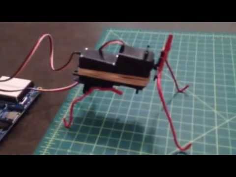

Many of you may have seen this photo over on the Parallax Facebook page. Ken, some others, and I have been discussing a Bug Bot hack for the Hackable Electronic Badge. Ken beat everybody to the punch with this photo of a three servo model.
I was hoping to build a two servo model (inspired by Mark Tilden's BEAM Two Servo Walker from Junk Bots, Bugbots & Bots on Wheels. I would, of course, use the Hackable Badge as the brains. Mine will be dubbed the "Badge Bot!" Here is a proof of concept (not that it really needed proving!) video for you review. I will keep you all posted. Input please...

    Thanks guys! Check out the amazing Phil Pilgrim, aka Phi Pi's MoBug (I wish this had made it to production. I especially like the whiskered like cut legs!) This is a different servo configuration and notice the way the front legs sit up on another leg segment. Climbs good and the rear legs push well.
    Next step is backing up - turning forward and backward in either direction and then on the erco figure eight challenge! ;-)
    Phil's bot is particularly well-done since it really picks up the rear legs too. Other 2-servo walkers mostly drag their rear feet on the ground. Tilting the servo axles "just right" and finessing the CG makes all the difference in the world. Bravo, PhiPi! This would make a worthy badge bot. WANT!

    Phil is the man! I played with his configuration a bit today. It is hard to capture a good look from the video. It is much more nuanced than you would imagine. Still trying...
