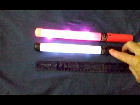

    Very cool, and as you say a lot of work! Getting even illumination via the right diffuser can be as hard as everything else. I have used tracing paper, waxed paper, my favorite is the white/clear/translucent material (probably sheet polypro) 3-ring notebooks. It cuts and scores to fold nicely. But gluing it is a pain, I use CA sparingly.
    On my PWM tube turbines, I used big blue soda straws with a jumbo white LED in one end, shining down the length of the tube. On the unlit end, I used waxed paper, one tapered length plus a lightly-crumpled ball. Worked great.
    There's also some interesting reflective diffuser material in these Dollar Tree light wands.
