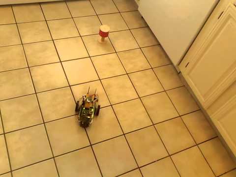

    You posted a question to my wall, but I thought I would show you what you can do with the gripper.
    I used a homemade laser sensor to located the target and a Ping))) to determine the distance. I then have known pulse widths that open and close the gripper. The code you posted is on the right track and IR sensors will work, but aren't as accurate as the laser and Ping combined.
