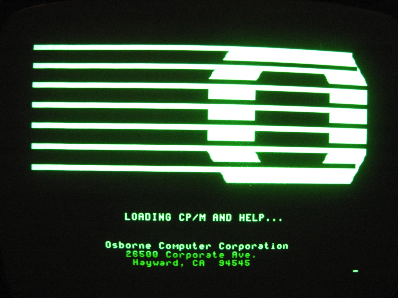

  • Those staggered green phosphor waveforms remind me of something else

  • cgraceycgracey Posts: 14,293
    Tubular wrote: »
    Tubular, you were rather young in the Osborne days, weren't you?
