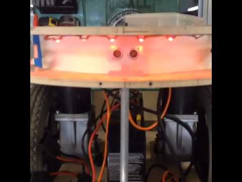

Front or rear different inputs it will not read above 5 inches. it will go down though.
Standard ping code. Works for the 3 other pings.
This code just turns leds from green to red base on distance sensed.

What happens if you only try to read the front or the rear alone? Looking at the code I'm wondering if your Pings are picking up the sound of another Ping.
Remove the Ping for a bench test. I just had an interference issue on a bot from wire routing. A pwm wire bundled right next to a servo control wire made the servo spaz out. Had to reroute wiring. Shielding was another option.
The main wildcard is the set of LEDs. Those can pull a lot of current, so if you're running them off the 5V regulator on the Arduino, there may not be enough juice to fire the Ping at full volume. For testing unhook the LEDs and try again.
Do all of the Pings, including the good ones, tick?
I would also route one of the working Pings to the pin used in your example code that demonstrates the problem. That will help rule out if you've got some bad pins or ports on your Uno. On the Uno they group pins by ports; any port goes out, it can take all the pins on that port with it.
As noted in comments above, you can only reliably fire off one Ping at a time. Otherwise you may get false echos. Even with that, I'd put your Ping code in a user function, with local variables to the function, so you can isolate the return values.

CAUTION TURN YOU SPEAKER VOLUME DOWN
And the clicking is the ultrasonic pinging I think?? Video from iPhone 5
