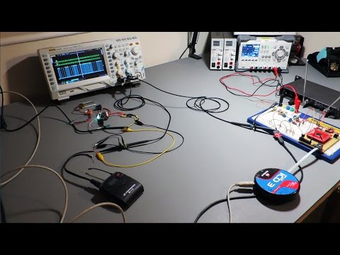

We've been continuing our old-school telephone gear + Propeller shenanigans and the latest project involves using the Propeller to get onto the internet through an acoustic coupler. Thought we'd share:
(EDIT: had to blur out some extra frames!)
Old school IRCing at 300 baud with a Propeller *woot!*
We're also generically tracking the project's step by step progress on our reddit: https://www.reddit.com/r/Tymkrs/comments/3f88ck/internal_phone_network/
Simple code: http://pastebin.com/MWveACWM
@tymkrs

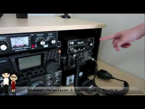

  • Haha, I do have my ham license! It's how I got started in electronics :D Here's my hamshack in fact:
