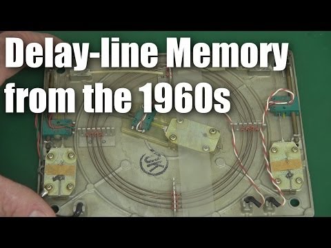

Hard to believe this actually worked. Anybody remember this old tech? Twisting nickel strands in a long coil. I'm still not sure how it seperates the "bits" on readback. The neat old guy in the video (sounds likee EEVblog's Dave's Dad) says it predates him, so this really is old school. BTW that guy also has a Youtube channel with some other interesting stuff.

    Even pre-dates my time. Back in the day they tried acoustic delay lines with wires. More successfully with tubes full of mercury. Somewhere on youtube is a great video describing Colossus rebuild at Bletchley Park and it's mercury delay line memory. Sorry I can't find it just now.
    Separating the bits on read back is much the same as problem as our old acoustic modems back in the day, or saving digital data to cassette tape.

    When a pulse of current is fed into the transmitter coil, the build up and decay of magnetic fiux in that part of the tube within the coil causes a longitudinal contraction in physical dimension in accordance with the Joule magnetostrictive elfect. This elastic disturbance is propagated along the tube at the velocity of sound in nickel. (At average room temperature 4900 meters per second or 5.27 microseconds per inch.)
