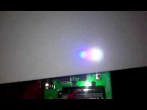

It's on like a prawn that yawns at dawn. Who can write the smallest BS2 program to blink 5 LEDs independently at different (non-multiple and readily variable) rates?
Code, video & memory map count (eg: EEPROM 27% full) please.
Winner gets a free Quadrover, is that OK by you, Ken & Matt?
  • ercoerco Posts: 20,260
    edited 2015-06-24 20:15
    EEPROM 4% full. Video to follow.

  • Beau SchwabeBeau Schwabe Posts: 6,568
    edited 2015-06-24 21:36
    EEPROM 3% full. Video to follow.
    ' {$STAMP BS2}
    ' {$PBASIC 2.5}
     DO
     W10=W10+1
     PAUSE 50
     IF W10 //5  =0 THEN TOGGLE 0  ' value 5 is timing constant
     IF W10 //9  =0 THEN TOGGLE 1
     IF W10 //17 =0 THEN TOGGLE 2
     IF W10 //29 =0 THEN TOGGLE 3
     IF W10 //41 =0 THEN TOGGLE 4
     LOOP
    Video Link:
    https://www.youtube.com/watch?v=wJ4jVkU86EU&feature=youtu.be
