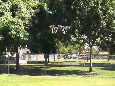

  • Repairs have been completed on my Elev-8. I had to replace the booms as they were bent slightly from a crash, and I was concerned about alignment. I replaced some bent screws, fixed a couple of bad solder connections and had to replace a damaged motor and faulty ESC.
    I've taken it out for a test flight - it seems to be flight worthy. Here's a pic:
  • Here's how I found the solder problems: https://youtube.com/watch?v=6-imBFz-HYk
    Here's a video of a flight at a local driving range: https://youtube.com/watch?v=ckw2yu9YWHQ
