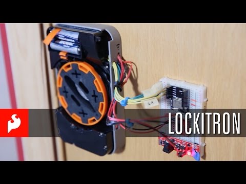

    I just ran across this thing.
    https://www.sparkfun.com/products/13648
    Seems like a pretty easy way of making a deadbolt into an electronic door lock.
