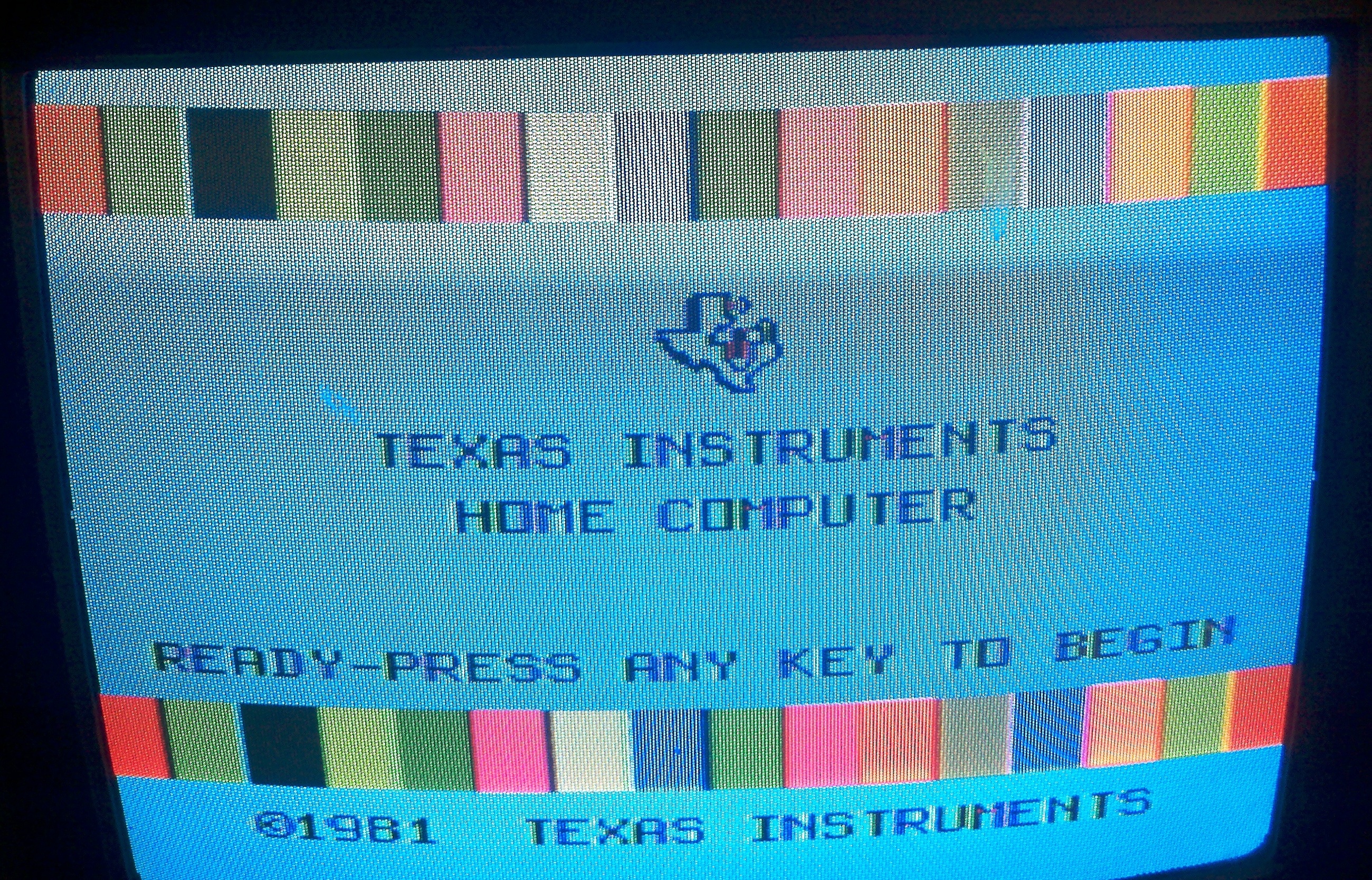

    Can you link to the driver you are using? I'll explain generally with the NTSC Template linked above. I can break out the lines of code, if you want. Just gotta get to another machine.
    In general, the PLLA frequency is the fundemental unit of timing for the whole driver. It's either set to the colorburst frequency, or some multiple of it.
    The colorburst, in the active display area, repeats X number of times. For NTSC, and a standard "safe area" display having an overscan border, that will be 160 cycles. For reference, many old computers synchronized their pixel clock to the color burst. This is what made artifact colors work, for example. On an old Atari computer, that colorburst cycle was referred to as a "color clock"
    Pixels clocked out at the colorburst frequency, are longish, and there are 160 of them for a standard, safe area display, and they can be any color without any significant artifacts. This is because there is time to fully describe the color information for that pixel.
    The TMS chip, Tandy color computer, and other 256 pixel computers made each pixel less than the color burst, which is overdriving composite video color somewhat. You can see the color artifacts in this TV screen shot: http://mit-a.com/Images/Actual/TI%2099-4A%20screen%20shot.jpg
    Look at the "H" and other letters with vertical elements. The pixel is "thinner" and faster than the colorburst cycles are on the scan line.
    VSCL works in PLLA cycles. There is the frame count, and the individual pixel count. An individual pixel is expressed in terms of PLLA, and the size of that pixel on the screen can be thought of in terms of how many PLLA / color burst. In Eric's NTSC template code, PLLA is 16 * color burst, meaning there are 16 PLLA cycles per "color clock" and to get one pixel per color clock, the pixel count would need to be 16 for VSCL, and to get 8 pixels per waitvid, the frame count is 128.
    Multiply the number of waitvids, and their frame count, and you get PLLA / active video area.
    For the NTSC Template I've linked above, that's 2560 PLLA / scan line.
    When you adjust the pixels in the active display area, you gotta keep the number of PLLA cycles consistent, or your scan line won't be the right amount of time.
    In the example I gave above, assuming standard NTSC borders, there are 160 pixels. If you wanted 320 pixels, you would set the VSCL for the waitvids in the active area to 8 for the pixel count and 64 for the frame count. This makes the pixels twice as fast, and they take up the same amount of time.
    If you wanted 256 pixels, do a little math: 160 color clocks / line * 16 PLLA per pixel default = 160 pixels = 160*16 = 2560 PLLA for the active area.
    You can do that computation for any working driver, not know a whole lot about the rest of the signal timings, and modify the pixel counts in the active area safely. Just count up the active waitvids, look at their frame timing, multiply, and that's how many PLLA you have to work with on that active area. And you can take the PLLA frequency, divide by color burst to understand how many PLLA you have per color clock, or colorburst cycle on that active area scanline.
    So for 256 pixels, take the 2560 pixels in the active area being used right now, divide by 256, and that comes out to 10 PLLA per pixel, and for 8 pixels, a frame count of 80.
    Now, more pixels = more waitvids! So you take the 2560 PLLA / 80 PLLA per waitvid, and you get 32 waitvids, and since each waitvid will have 8 pixels, because 80 PLLA total / 8 PLLA per pixel = 8.

    OK, so assuming we have 256 pixels and we have 32 pixels in a long, that means we have 256/32 = 8 waitvids for the active area.
    My graphics loop (that will fetch pixels) will need to execute 8 times for the active area.
    So now to calculate VSCL. We have 2560 PLLA per scanline. 2560 / 256 pixels = 10 PLLA per pixel. This "10 PLLA per pixel" is called the color clock.
    We now have 10 * 32 = 320 PLLA per WAITVID. 320 PLLA / WAITVID * 8 WAITVIDS = 2560. Bam. It all matches.
