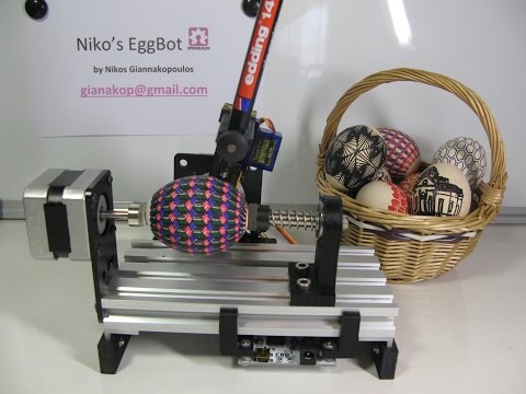

Hello everybody,
Easter comes, and what could be better than an EggBot?
The answer is: a Propeller EggBot!
I have already make a very cool design for Eggbot using OpenBuilds parts, 8 3d printed parts from my 3d printer, and the original EggBot's electronics.
I could say that the robot is perfect! However my ambition is to replace the original EBB Driver Board with the Parallax Quickstart board in order to make much more powerful that mini CNC machine.
I have in mind this:
So, can anyone contribute in this effort?
I ask help in order to drive 2 NEMA 17" bipolar stepper motor with Propeller and also comunication with Inkscape software.
Yes or not you can use my design in conjunction with the original EggBot electronics for a cheaper and very professional EggBot.
You can see the project on OpenBuilds and on Thingiverse
Fell free to ask any detail.

    Hi Nikos,
    very nice design of an EggBot!
    I build one with a very simple frame out of wood. Yours looks much more professional.
    Your Eggbot is drawing really quick.
    How did you manage to eleminate play in the pen's arm? There is quite some inertia in the arm which causes my arm to oscillate at high speeds.

    StefanL38 wrote: »
    the real speed of the robot is the first 14 sec of the video.....
    Then I increased the of the viveo's speed in order to save time.....
    StefanL38 wrote: »
    I hope the next image can help...
    800 x 600 - 124K

    edited 2015-04-01 18:43
    Nicely done, Nikos! I was wondering how you accommodated different-shaped eggs. The HINGE and GRAVITY!
    edited 2015-04-02 06:15
    yeah that's one of the amazing details about the eggb....
    1024 x 799 - 33K
    Hi Phil,
    From my experience in order to paint successfully different-shaped eggs, I must have the pen motor to the right position.
    On the EggBot Pro you adjust the different=shaped eggs (From ellipsoid to round eggs) moving up or down the pen-motor.
    Using the OpenBuilds parts acording to my design, we can achieve exactly the same functionality with the original EggbotPro.
    867 x 1294 - 297K

    StefanL38 wrote: »
    .....If you apply a force in direction of the length-axle of the egg
    (= in direction parallel to the egg-turning axle) do you observe some play?
    No everything is ok! I have no play! The hinge that I use I think is a perfect solution! I think that it is by far better than the system that has the wooden arm of the original Eggbot ....
