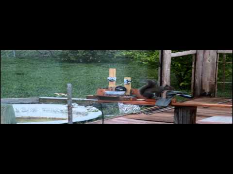

Haven't done a electronic project in over a year and was afraid I had forgotten the little bit
I had learned about circuits and working with Spin.
It mostly came back to me and it helped that the first project back in is a "Frankenstein" of
past projects.
I thought I would post pictures and take guesses on what it does.
If the guesses are better then what it actually does, I will go back and change what it does.
1024 x 683 - 651K
910 x 1024 - 831K
  • RagtopRagtop Posts: 406
    edited 2015-03-01 05:47
    No guesses?

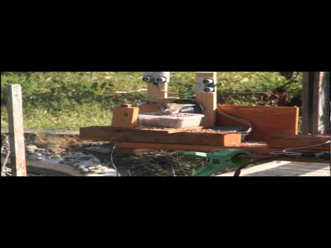

    Well, the next picture of the remote unit in it's location pretty much gives it's function away.
    The remote unit uses two ping sensors to determine if something has landed on perch or bowl. (distance < 300mm)
    It takes a picture and sends which sensor was hit and distance from both sensors back to the base station.
    The remote unit is also listening on the xbee to see if any buttons have been pressed on the base station
    If the visitor has fur instead of feathers, I can play one of three tunes on the car alarm next to the bird feeder.
    If I want to take more pictures, I can control the camera with a button on the base station.
    The base station blinks a light and sounds a buzzer when either of the ping sensors are hit. It also records the hits
    to a file on the SD card.
    So far, everything is working except for visitors.
    Next up is adding a video camera to the mix.
    1024 x 641 - 527K

    This is from a test of writing the data to the log file on the base station's sd card.
    It creates a comma delimited file telling 1) which sensor 2) time 3) total minutes
    4) distance from perch sensor 5) distance from bowl sensor
    It also records when I press a button on the base station.
    The total minutes field proved unnecessary. I was having trouble with
    Excel charting using time for x and distance for y. It didn't seem to be spacing
    out the time interval, but I was using the wrong chart. Line chart spaces each
    data point equally along x axis, but XY chart accounts for gaps in time.

    Not a MIT grad, so it requires visual (human) identification as the feeder is outside my window.
    In the background are banana plants that hopefully are not completely dead with the few days of below freezing we got.

    Was afraid the birds might be able to hear and be annoyed by the ultrasonic frequency, but visitors are starting to come in.
    edited 2015-03-28 15:03
    Finally got a squirrel test subject for the Car Alarm deterrent which turned out not to be a deterrent at all.

    Squirrel and Deer are the most difficult animals to scare off.
    It might pay to add some type of motion like a servo operated gloved hand.
    The motion helps with deer.
    Also, deer do not like George Thorogood music.
    Not sure about squirrel's.
    The birds do not seem to be affected by the deturrents I've built.

    Finally got around to adding the contour video camera to the rig.
    edited 2015-05-03 13:08
    Some more pictures from the rig. I moved the camera off to a tripod as I believe I had the camera
    too close on the rig both for focusing and scaring the birds when the shutter went off.
