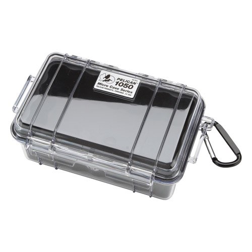

    Another idea, use a clear pelican case. Only about $15, should be fine for the meager 1 meter depth requirement - actually rated for 1 meter submersion for 30 minutes.
    http://www.amazon.com/Pelican-Micro-Snorkelers-Kayakers-clear/dp/B001CNNEXE

    The CHDK stuff looks pretty interesting, and the Canon ELPH cameras are relatively inexpensive. I like the idea of using a hard case, such as the Pelican 1050. Thanks for all the suggestions! And I'll definitely be checking with B&H.
