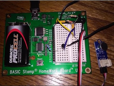

I'm working on a music project for the twins, who are learning to play recorders (little flutes). It's simple enough to detect sound versus silence, I'm wondering if there is a simple microphone+audio amp+filter/clip circuit that might condition the recorder sound so a Stamp could tell the difference between 3 or 4 different tones using COUNT and light different LEDs. The notes can be spaced apart as necessary, don't need to be adjacent.
No doubt, it will come down to the purity of the sound produced (harmonics+other noise) by the recorder. An electronic square wave generator could make audio frequency tones that would be easier to detect, but it would be more magical to use their recorders. My backup plan is using more hardware like several 567 tone decoders, but a software solution would be much simpler.
Has anyone tried anything along these lines? Those silly little whistle keychain beepers that are nothing but a piezo sensor/speaker and epoxy blob make it look easy.
    edited 2015-01-19 20:09
    After doing a little research, I think I'll try a kazoo instead. That buzzy sound has got to be more digital/square wavy than a recorder.

    Turns out a Stamp does just fine with a variety of toy flutes and recorders, and there is plenty of potential to do more, like auto-harmony.
    '{$STAMP BS2}
    ' {$PBASIC 2.5}
    ' sample twice, discard if vastly different
    PAUSE 100
    Main:
        COUNT 15,50,W1
        COUNT 15,50,W2
        IF W2<W1 AND W1-W2>3 THEN main ' discard if 2 samples are more than 3 apart
        IF W1<W2 AND W2-W1>3 THEN main ' discard if 2 samples are more than 3 apart
        W1=W1+W2 'update W1, now total ~similar to COUNT 100
        IF W1<30 THEN main   ' ignore LF noise & pauses
        W2=W1*10
        FREQOUT 9,500,W2
        IF W1>49 AND W1<55 THEN DEBUG "CCC",CR:GOTO main    ' 52-53
        IF W1>56 AND W1<62 THEN DEBUG "DDD",CR:GOTO main    ' 59
        IF W1>65 AND W1<68 THEN DEBUG "EEE",CR:GOTO main  ' 66-67
        IF W1>67 AND W1<75 THEN DEBUG "FFF",CR:GOTO main  ' 70
        IF W1>77 AND W1<82 THEN DEBUG "GGG",CR:GOTO main  '79-80
        IF W1>86 AND W1<93 THEN DEBUG "AAA",CR:GOTO main  '89-91
        IF W1>96 AND W1<103 THEN DEBUG "BBB",CR:GOTO main  ' 98-99
        IF W1>102 AND W1<109 THEN DEBUG " HIGH CCC",CR:GOTO main  '106-107
    GOTO main
    edited 2015-02-16 17:05
    Does OK on a piano, too. I think the FFT is a money laundering scam. :)
    Yes, the backup plan was to use a 555 oscillator, but this is already working better than expected with the recorder flute, so I'm good to go. :)

    I may the only one who finds this thread interesting, but I'll keep sharing my experiments here nonetheless. :)
    ' {$STAMP BS2}
    ' {$PBASIC 2.5}
    PAUSE 100
    Main:
        COUNT 15,50,W1
        COUNT 15,50,W2
        W2=W1*10
        FREQOUT 9,500,W2
        DEBUG DEC W2,CR
        GOTO main
