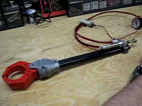

    I just found a video by the Nut's & Volts magazine author.

    The video in post 11 is pretty good at demonstrating what I know as a Meter Out system.
    I've done this type of thing.
    The meter out pneumatic systems work pretty good as long as there is no mechanical binding of all of the linked together parts.
    If for example the pincher in the video were starting to close and for some reason, the mechanism were to bind.
    The air pressure on the exhaust side of the pneumatic cylinder would drop and speed control would be lost.
    When the pressure on the exhaust side drops low enough and the binding was overcome by the actuating pressure, the
    pincher would slam shut with great speed and lots of power.
    The video does not show that fact. That was not the purpose of the video.
