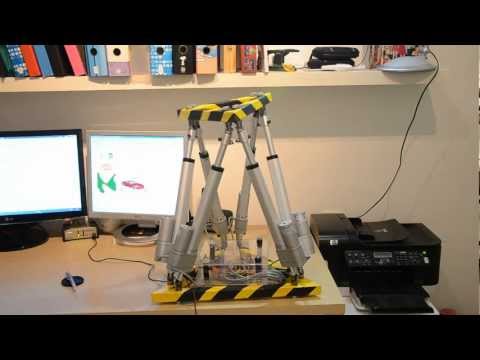

Here's a Stuart platform with a touch panel for feedback.

  • ercoerco Posts: 20,257
    edited 2014-12-14 18:56
    Those are all FABULOUS! Never seen a Stuart platform. A must-build! Great damping (PID props) in the first two videos, and a great effort by the young man in the last one.
    My favorite post in Robotics in ages. Well done, Martin_H! Keep 'em coming!

    Glad you both liked them. There's a neat difference between the Stewart platform and the other balance table, a Stewart platform can move up and down as well as tilt. So it's possible to bounce a ball on one.

    This related video shows how the 6 servos (actuators) in the first video make the Stewart platform a full motion simulator, not just a 2 DOF system.

    The forum software is giving me grief uploading this, so here's a link instead:
    http://ppl.ug/jFSaNjODWbo/
    The blue servo brackets and right angle brackets are from Gordon's website, the ulinks are from Tamiya, and the plywood is from the local craft store. Things went together quickly once all the cutting and drilling was complete.

    Daddy like! But I suspect you'll need longer servo arms for a bigger range of motion.
    Propeller controller? Big coding job to make sure your servo pairs aren't fighting each other. Cool project!

    What I can do if the arms need to be longer is flip the servos around and make arms from hobby plywood. I've already got C IK software that's parameterized so I would only need to plug in some new values.
    I do plan to use the Propeller and SimpleIDE since I have all the code in C. It's definitely a big coding job, even with the headstart I have from previous IK projects.

    Martin_H wrote: »
    That's starting to sound like a lot of work! Another option is to move the brackets on the top platform closer to the center, as shown in the very first video you posted. Half the radius there yields twice the travel.
    edited 2014-12-29 17:42
    That might work, but I was shooting for an equilateral triangle for the length of the rods versus their separation on the top disk. This is roughly in line with other Stewart Platforms I've seen. But we'll see how it goes. In the meantime there's a bunch of C++ code to write.
