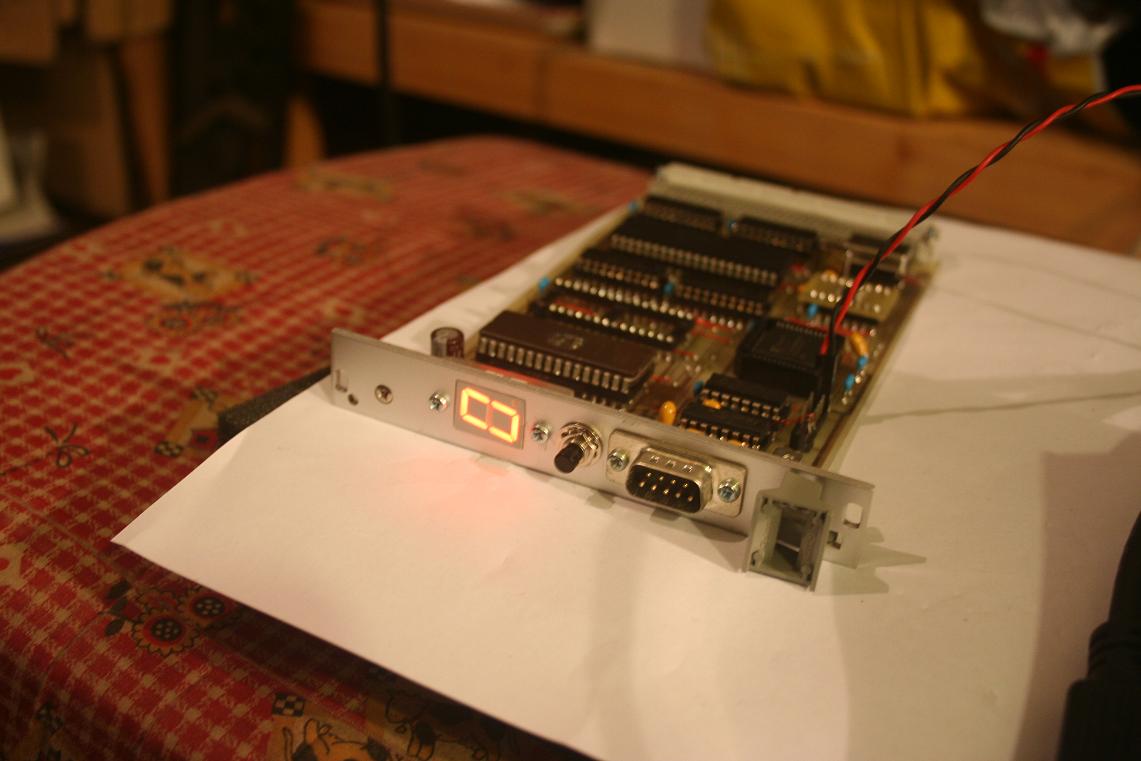

    I was thinking at a Z80 emulation as well .. but that I think would pose a problem .. you need at least 64K memory to run CP/M 'properly' and I'd rather use it just as a terminal emulator rather than having a full z80 emulation/stuff on a Parallax.
    You can have a look at the .ZIP attached which I made/the approach I am taking as I said it's a bit of a learning/fun process to me, I am totally new to this.
    The idea is a pretty basic "state machine" which scans the codes and .. does things .. I am still hacking/learning/chopping/debugging stuff. For "simplicity" at the moment still using SPIN, you may have a look to see "the kind of road I took" so far :)
    "Please excuse my naive SPIN code" or such :) There's a bit of debug stuff there and there as well.GilesTestVT.zip
    Ah of course "I claim no (C) and such or whatever" I literally trying to learn and have some fun so take all things just like "a few hours project" .. but I'd be happy if I can make it work OK to be used with my ( bigger project CP/M machine ).
    ( this one in case you missed it http://www.gilesgoat.com/Yak/FirstRunSBCZ80.jpg )
