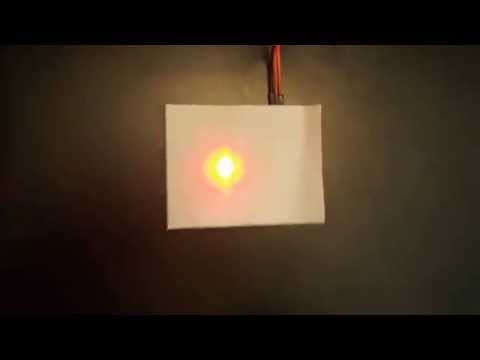

http://youtu.be/os6fUiua4D8
First then Thanks to @David and @MJB
and the color words just modify the colors array directly.
@fride - whoops, faster should be less of a delay. LEDs could be called from CHASE if you want and then just keypoll CHASE.
The main thing was to make sure that bit of code was handling the bit timing correctly, then it should be possible to do some fancy stuff at the high level interactively, even just typing in one line loops without actually creating a definition, as is possible in Tachyon.
