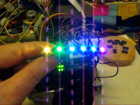

    I think I figured the problem out but not sure why it works this way. When I program to RAM it only cycles 5 or 6 times. However, if I program to EEPROM it works like it is suppose to. Anyone know the reason for this?

    What I am wanting to do is to be able to have my 6 LED's light up one after another with various colors of the rainbow. So, LED 1 would be red, then go green and LED 2 would be red, and so on. I want to be able to easily add colors based on the RGB Table here. I do not care if it is SPIN or SimpleIDE, I just would like the color chasing option and also the option to add and remove various colors. I am able to use the program David Betz created here but when using colors I define all 6 LED's light up with the same color at once.

    Andy, I'm working on a simple demo for your six LEDs. Hopefully I'll post it soon.
    What are you using as a power supply?

    I agree but a few LEDs usually will run off of USB power.
    The attached code drew about 200mA on with the Activity Board using six LEDs.

    The main loop sends one of the colors listed in "colorTable" to the a LED.
    @Andy, Let me know if this is close to what you want the LEDs to do.

    The only time the LEDs are off is at the very beginning of the program.
    I'm uploading a video showing the code in action on an Activity Board.

    My camera has a hard time with these LEDs. I used a sheet of white paper to diffuse the light a bit when I made the videos embedded in post #3. The white paper makes the colors easier to see but the camera still fails to capture how cool these things look.
